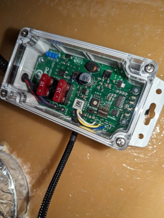

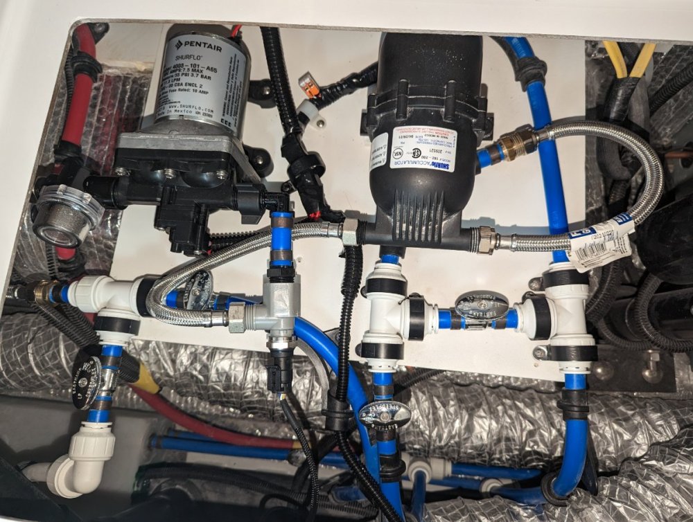

Easy modification for Ollie. Could have factoring issues when pulling water for boondocking but modifiable. Quieted pump down, uses less watts. Like ez start for water pump.
Very customizable. Has leak detector. Customizable in many situations.
Pump shuts off after running over 1 minute, then have to turn pump on and off again.
Dip Switch 6 can disable on system. Has pressure and runtime sensors. Uses less electricity due to soft start and less startup of pump.
Decided to replace and add when the unit I purchased was not winterized and had to replace pump anyway.

Certainly this seems to offer a bunch of options.  But, at $200 I'm not so sure that I really need the most of the options that are offered.
Please update your review over time to see how well this unit performs.
