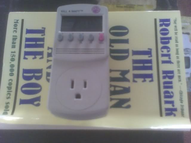

Here is a photo of our Kill A Watt meter:
You plug it into an outlet then plug your appliance into it. Various push buttons give you the different data you need.
The meter sells on eBay for $20/25.
