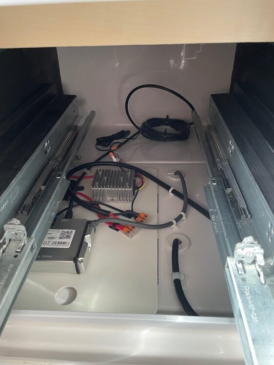

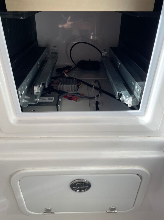

So, I converted my [version 2] Starlink to run off 12 volt and without cutting or modifying cables using Yaosheng branded adapter found on Amazon: Injector with Comprehensive Protection for Standard Actuated Starlink. Additionally I am using my own tp-link router.Both the Starlink Dish and router are powered off 12 volt. I mounted everything inside and underneath the nightstand drawer. See photos attached. You won’t see the router here where I use it in the house when we’re not traveling.
