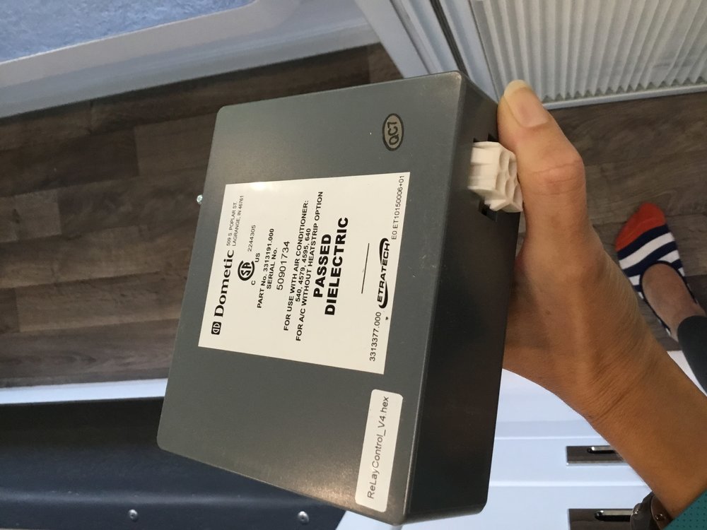

  2. Thanks Bill! Right you were. There is no control box. No wonder I couldn’t find it. Sorry to take a while to reply- I moved residences, and we all know how that goes.
  3. quickie-anyone know where the ac control box is? Would look like this (see photo). I have a dometic led thermostat that’s not receiving voltage. The control box doesn’t seem to be in the ac unit.
