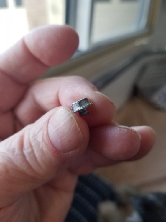

  7. Thanks. Yes it's a 2017 of course. Lost about 15 through out the trailer so far. I have not tightened them. We just find the heads of the screws laying around and find where they have broken. No rough terrain driving at all.
  8. Has anyone noticed the heads of the screws holding the interior window trim are breaking off. It's like they were all over tightened at the factory weakening or just breaking the heads that are beginning to fall out. Other than drilling out each one does anyone know a remedy for this. Cheap imported screws one issue I think along with wrong screw gun setting.
