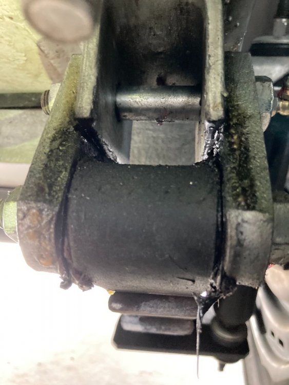

  1. Not sure if all the Elite I trailers are the same throughout the years, but my 2020 Elite I has a rear leaf spring hanger that does not have a bushing. As a result, any grease put into the upper rear grease fitting will just exit the bolt mid-air and drop down on the lower shackle point. Therefore, in my case, any grease used on this zerk fitting is a waste of grease. I am awaiting a response from Jason E on why a wet bolt is being used in this location and what might be done to ensure lubrication of the bolt to hanger contact as well as the side of the hanger and the shackles. With less than 2K miles on the trailer, I am already starting to see a gap at the bottom of the bolt indicating either the bolt or the hanger is starting to wear.
  2. Overland, On the single axle (my case) the shackle is installed on the rear hanger and the shackle then attaches to the spring eye. On the tandem axle the spring eyes attach directly to the hangers and therefore have the bushing. Here is a YouTube video of what I am talking about. Here is a photo of my front and rear hanger from the side.
  3. Yes, Neither side was designed with a hanger that has an integrated bushing. Dexter sells rear hangers with and without bushings. Not sure why Oliver went with the one without the bushing. Biggest concern is that the bolt and/or the bracket will experience some significant wear in the near future. I will be keeping an eye on how much wear occurs over the next few thousand miles. In the meantime I am in the process of purchasing some spare bolts to have just in case the bolt fails out on the road.
