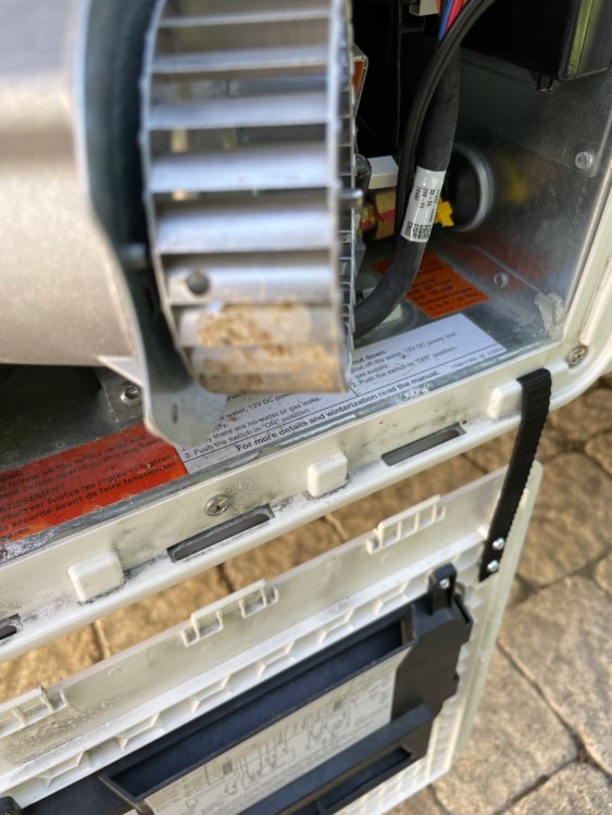

  9. Mud dauber nest attached to fan blades. I had peered into the flu and saw the typical dried mud dauber mud crumbs. I took the plunge and removed the fan. Sure enough there was the nest and mud on the blades where it had been attached. Cleaned the blades, tossed the nest and reassembled the fan to the Aqua Go. The hot water heater is back in business. Thanks so much for the hints. By the way the screws are T15 Star drive. I was fortunate and had a long enough magnetized screw driver that allowed their removal with less chance of loss. And one more item. The mud dauber came by while I was working and said, “What the heck!”.
  10. My Truma Aqua Go shows an E 25 W error code (Flue fan current consumption error). What’s the fix before I call Truma. Thanks
