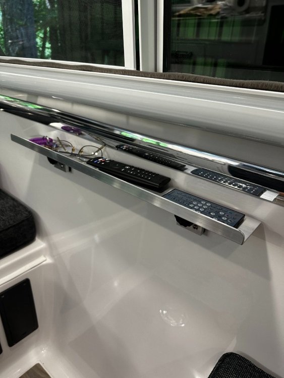

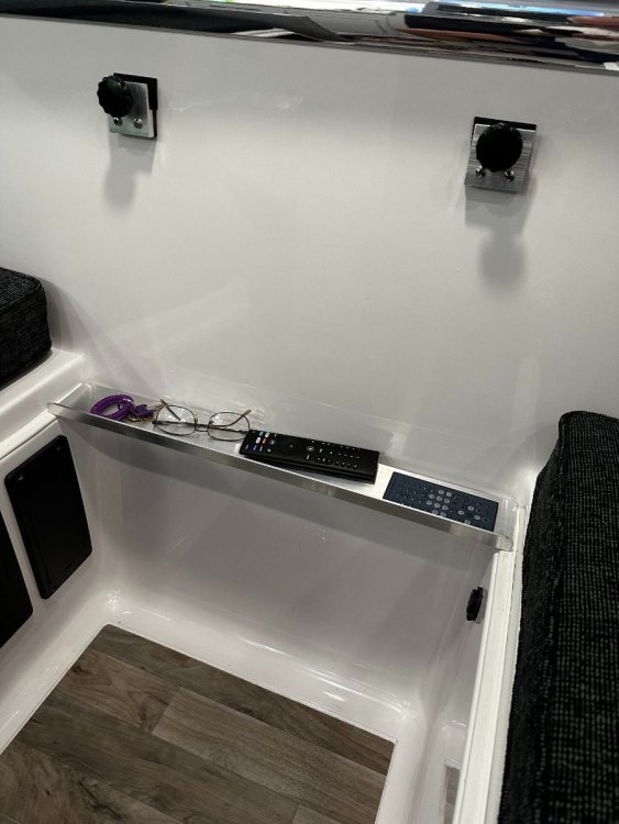

I modified the modification. I rounded the top corners and cut slots on the bottom leg so now it can be used below the table too. -

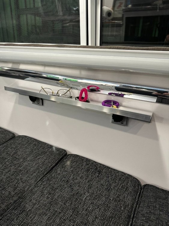

Yes, I filed them smooth but I agree and will round them off. I purchased the z-channel from Eagle Aluminum in Loretto, MN. -
I made two shelves for the brackets where the tables are mounted to the interior wall. Works great for small items and iPhone. Photos below. Only problem is that I needed two 24" long pieces of aluminum z-channel but had to buy 24 feet. Now I have 20 feet left over so if anyone is interested in this mod and wants some of the z-channel you can send me a PM. In addition, I swapped the thumbtab bolts out for knobs. This is my first post so I hope it works correctly - let me know if I need to change anything. I am working on another mod that I intend to post. David

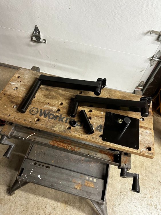

Ron, Following up on the articulating table mount. Here is what I plan to install in "Coddiwomple" (Elite 1) when we get it next spring. With this setup we should be able to position the tabletop next to the stovetop and my wife is happy about that. It is a lagun-type removable table mount and seems to be very strong. The powdercoat finish is nice and the fit is tight. I contacted Foy and he can make a tabletop for us with the underside routed out to lighten it up so I will order that later when I dial in the final tabletop dimensions. Need to figure out support bracing and backing later. Might have to have a custom brace made so as not to stress the fiberglass. I purchased this from EZ-Reach (division of Cass Hudson) and spoke to the design engineer about my plan to add a second arm so I would have an elbow like movement rather than just one arm with an arc. He thought it was a good idea and would work so I ordered two of the 12" arms. I cut one tube down so it would fit in to the other and it works great. I extended it out all the way and put 20lbs on the table bracket - It is solid. Now I just need a trailer to install it in! David Purkey -
