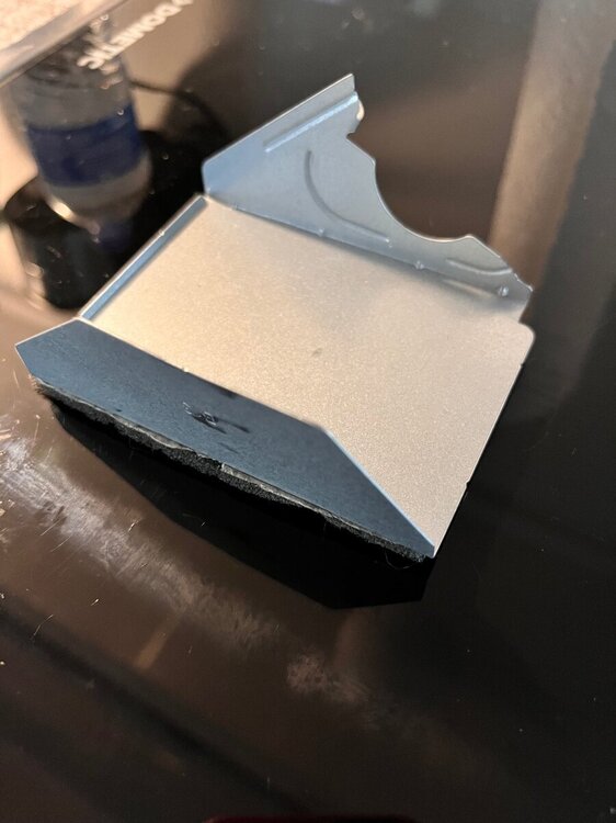

We unplugged MW, “we’re going in”…
Opened up case,
Found a loose part,
Spent considerable time trying to find out where it might be within the case.
Could not figure/find where it went, SO
Closed up case,
Reinstalled MW into cabinet.  NO EASY FEAT…
MW no longer trips GFIC @ inverter.
As soon as we can FIND ONE, we will get to Appliance store and ask about loose part.
MW is a High Pointe installed in 2020 in our LEII.
Model# EM925AQR
