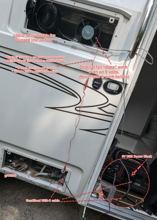

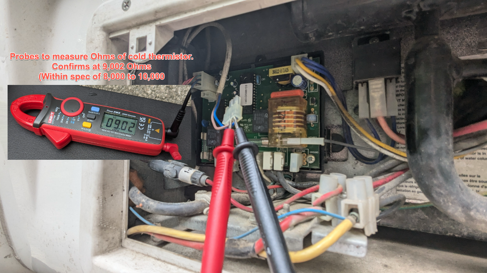

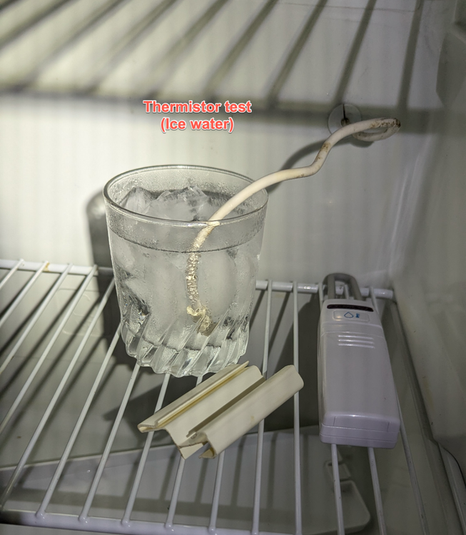

Well, I had to use what I had on-hand to confirm the fan functionality and I verified the thermistor.  The fan has never worked and I've confirmed that... no 12v power is arriving to the fan push-button switch inside the camper.  I'm not really wanting to pull out the refrigerator just to find the broken 12v wire.  I'm afraid I'll brake something more important.  That's one issue.
I did confirm the inside switch and the fan itself do actually work. To verify the fan, I used an old USB cable to plug into a 9v source and a USB-C power block (AC) from an Amazon Fire TV stick. At first, I used a 9v battery to verify the fan worked, and it did (yay).  I have never seen the fan spin before, ever!
Now I'm thinking of finding another 12v source, or more likely, if I can use the 120v AC plug for a 12v block, instead of pulling out the entire fridge. I could run new wires from the fan. Something red-necky like that.

I did move the thermistor (sensor) inside the fridge up a bit to the very top, and it was not on the last cooling fin, but the second to the last fin.  I did not see any mention the placement of the thermistor mentioned in any of the RM2454 manuals.

That's why I took the recommendation of others to replace the OEM fan with a larger dual fan setup. You could change out the thermal switch screwed into the top RHS of the condenser. Given your fan works this is likely the issue. Note all the comments here.
It's worth the $80 plus tax and a few hours and YES, run new wires to the switch or wire without the toggle switch on the lights panel. The Beech Lane fan product it very nice. I just purchased and installed a second one to cool the streetside bed basement area where I'm installing a 3KW inverter.
