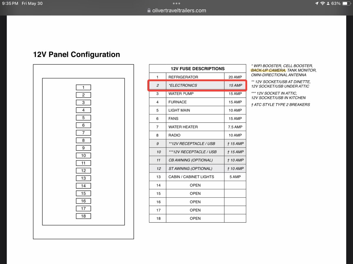

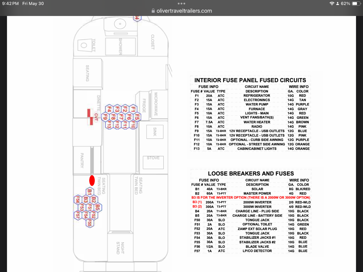

Hello again,
I recently purchased a TST TPMS system that includes a booster/repeater to get the signal to realiably link to  the head unit in my truck.  I am going to install it in the trailer this weekend and my thoughts are to include it in the Rear Camera circuit as both the rear camera and the TPMS will be powered up at the same time.  The power switch for the Rear Camera is located on the Entry Switch Panel but is not tied to the Master Light Switch (it can be on when the Master Switch is off).  Which DC fuse is inline with the rear camera switch- F2 Electronics?  F5 Main Lights? or is it something different?
Thanks for the help.
According to the 2022 LE2 manual, the rear view camera is powered by f-2, a15A ATC fuse with a tan 14G wire.
IMG_1415.thumb.jpeg.9e1523a6eef63a5a09fa4da8c0791000.jpegIMG_1417.thumb.png.6d503df03fc38a7fc92281351a67347a.png
Thank you - I actually did refer to the manual, I guess I just didn't look closely enough.  I was only looking at the fuse panel descriptions on the latter of the two pages you shared and did not look closely at the panel layout on page 35 of the manual.
