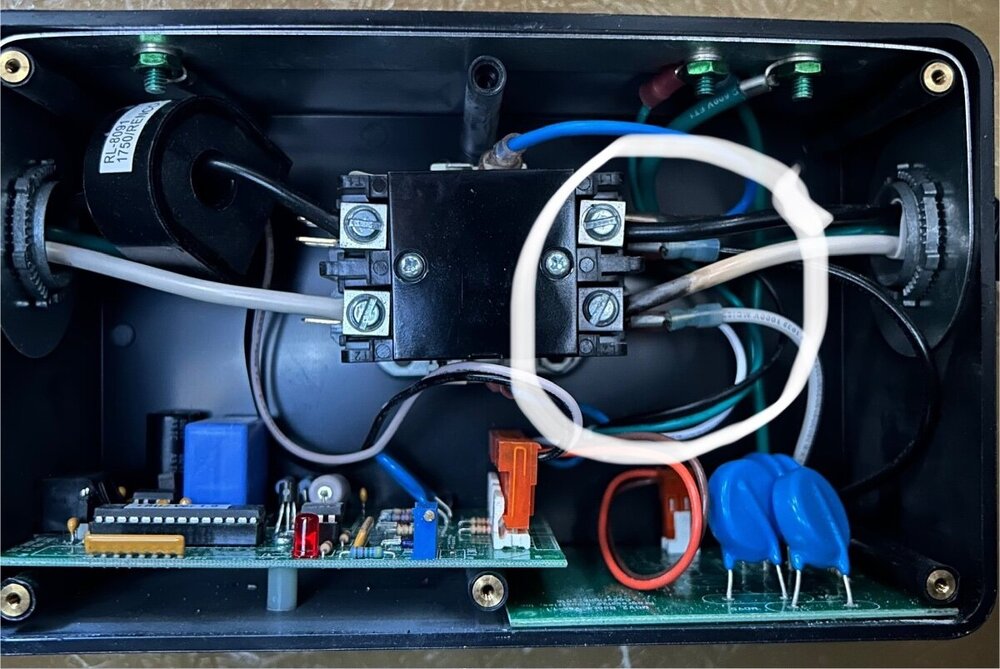

In a recent facebook post the Progressive EMS that is located under the rear dinette seat came into question.  The poster had been concerned about the other posts about the transfer switch and decided to look at the wiring in the EMS Unit in the same dinette seat bay.
Below is one of the pictures he posted showing his burnt wiring (in the white circle).
He also posted a videos showing the main power switching board completely loose as the bolts holding it in place had fallen off.
Since I already check the connections on the transfer switch each year, I decided I would also check my Progressive EMS unit as well.
Good thing I did as the bolts had fallen out just as in the Facebook Posting.

5) Inspected the wires and none were scorched.
6) Wiggled the main connection board and it was very loose...one of the two nuts holding it onto the 2 mounting bolts was loose, lying in the bottom of the case.
7) Checked for bolts (thread through back of case) Luckily the bolt was still attached to the case.
 (They are phillips head countersunk bolts. Which after working on them I taped them in place from the outside.)
8  Reconnected the bolts to the nut putting on blue thread locker.
9) Checked tightness of all the lead screws and the bolts on the 3 ground lugs (green). See PIX below:
10) Put lid on and then re-attached to mounting board and re-attached remote display network wire.
Tested with shore power and all was well
