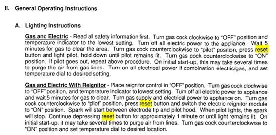

Also, walk through troubleshooting in your suburban manual. I've attached below a PDF of the 2016 OTT Owner's Manual. First, search (Ctrl-F) for keyword 'Suburban.' When I got to the Suburban section of the manual, I clicked on the first page of the section and then searched for the word 'reset' to learn what the reset buttons are for. It appears the reset is used for re-lighting the HWH (see pic below), it resets to go through the self-ignite steps again to restart. I'm not 100% on this, haven't needed to use it.
