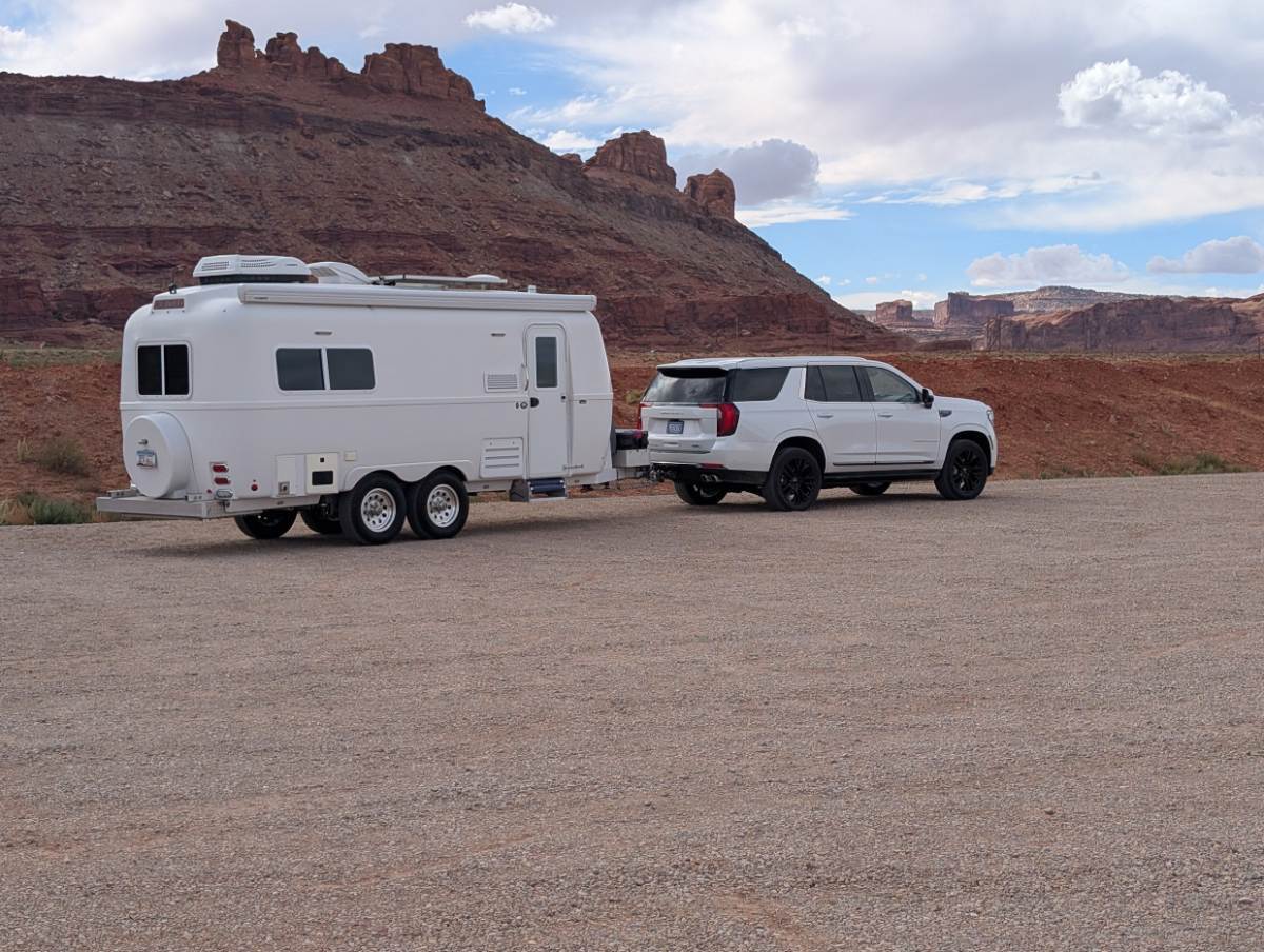

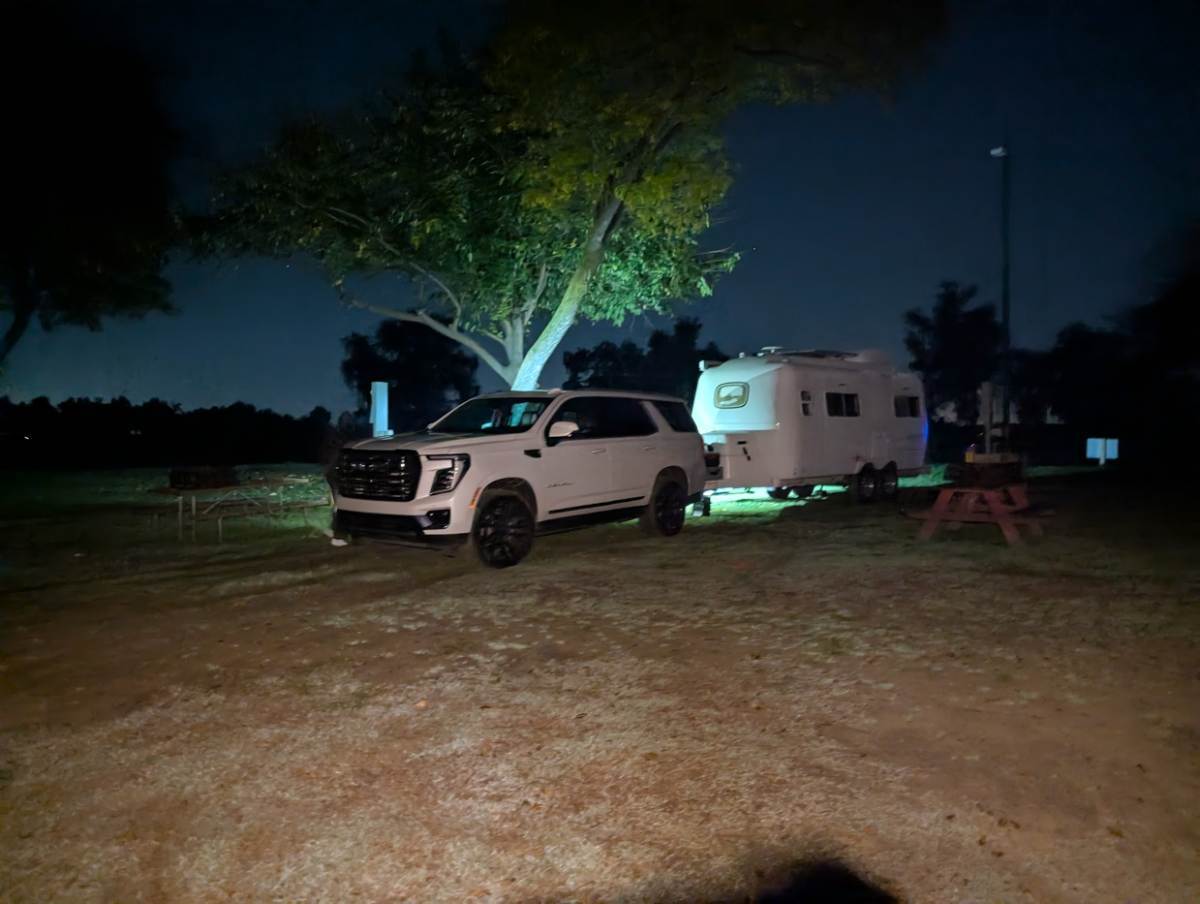

I towed with a Yukon and it pulled great.  No issues.  Ours was newer but we never had any issues with it.  When I bought the trailer, I picked it up a few hours away from home and didn't tow it back with the weight distribution connected.  Towed fine.  On longer trips, I did pull it with the wdh and never had any issues either way.
