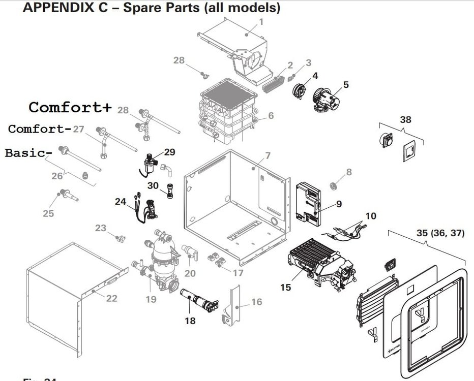

While the second attachment you have is somewhat of a parts list, this one is more of an image, of the left side actually, maybe it will help your search. 18 is the circulation pump

Nope, that's the Comfort+ schematic, same and only one that I could find. Is the same recirculation pump and fittings even in the comfort?... is my question... Because if it is, then a quick Tee and some line would turn it into the +, that's why I'm thinking the inside is different ant it may not need a recirculation pump for a short circle because the heat transfer would push it through like in the old wood fired Kitchen stoves with the water line plumbed in the back for the household hot water.

Here is the link for the Truma PDF it says it's all three systems and just lists that connector 3 is for the plus. So basically the guts are the same just that tee is added, makes me think they are probably all able to have it internally, just whether it's hooked up and configured.

I read through the PDF and like you said, the only difference is the Tee. So I'm going to call Jason and see if they offer the Comfort+ with the return Line.
