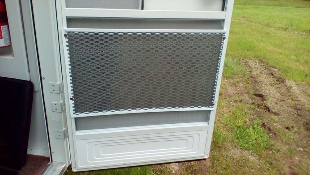

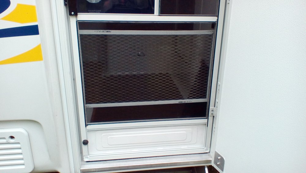

Mainiac Posted June 7, 2017 Posted June 7, 2017 Had a pet paw the screen door in an attempt to join us. Oops. It did rip the screen. Solution (hopefully) is a guard. Looked at the RV catalogs and they wanted $80. Next step..build one. A piece of expanded mesh cut to size. Plastic edge with mitered corners. Edges "glued" on with silicone caulk. Now waiting for the caulk to 'cure'. About $25. Next step, mount to the door.
Moderators topgun2 Posted June 7, 2017 Moderators Posted June 7, 2017 Assume that you thought about that "screening" that is "pet proof" - I think that is stronger and is a bit elastic. However, I like the idea of fabricating a solution. Any pictures? 2023 Ford F150 Lariat 3.5EB FX4 Max Towing, Max Payload, 2016 Oliver Elite II - Hull #117 "Twist" Near Asheville, NC

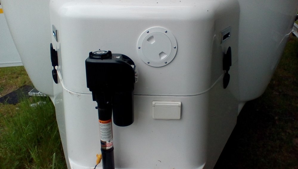

Moderators topgun2 Posted June 10, 2017 Moderators Posted June 10, 2017 How about a close-up of that porthole leash? 2023 Ford F150 Lariat 3.5EB FX4 Max Towing, Max Payload, 2016 Oliver Elite II - Hull #117 "Twist" Near Asheville, NC
Mainiac Posted June 10, 2017 Author Posted June 10, 2017 Not sure what I could 'zoom' in on. Basically on the inside of the cover is a little nub sticking up, with a star shaped hole in it. That hole is designed to take a screw. We used a SS screw so it wouldn't rust. We made the, as you called it, leash out of some paracord (it was actually a piece of what looks like thin camping clothes line). We cut it on an angle and fed that through the crimp on electrical connector. We fed it through until there was a quarter inch sticking out the other end. We crimp a connector on both ends and then light (or melt) the cord so it doesn't pull out. One end goes on the cover, the other over a screw holding the port on. Another locking nut holds it on. The screw and nut are a little loose so that the connector can swivel. I can take a picture if you like, just what to focus on? 1
Moderators topgun2 Posted June 11, 2017 Moderators Posted June 11, 2017 Thanks! A description is worth a thousand pictures/words. I'm always looking for things that will simplify jobs and/or automatically keep me from having to remember something. Now I will not have to remember to replace that cover since it will be attached. Bill 1 2023 Ford F150 Lariat 3.5EB FX4 Max Towing, Max Payload, 2016 Oliver Elite II - Hull #117 "Twist" Near Asheville, NC
