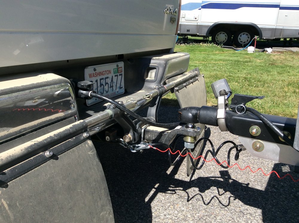

John E Davies Posted June 28, 2017 Share Posted June 28, 2017 Brad, I have a 2006 Ram 3500 4wd with slightly oversized tires (worn 33 inch diameter). I am using an extended 3/4 inch rise ball mount and a standard 2 inch ball (with 1 inch shank). Both are rated at 7500 pounds. My ball measured 23.5 inches to the flat on top and that has worked well. This was with the bed loaded with all the gear I planned to carry, plus a fiberglass Leer canopy, probably 700-800 pounds total. I chose a mount that was three inches longer than a regular stubby one, for better tailgate and bumper clearance for the coupler and the storage basket ... https://smile.amazon.com/gp/product/B0007M308U/ref=oh_aui_detailpage_o06_s01?ie=UTF8&psc=1 DO NOT use your 5000 pound rated parts! Your Class 5 receiver is rated for a gazillion pounds, don't fret about that part of the equation. Don't forget to bring grease for the ball and coupler. I towed the trailer dry from the factory to Falls Hollow CG, and it wrecked the chrome plating on a brand new ball. Any synthetic grease will do, I carry a 3 oz tube of brake caliper lube in the cubby of my dash, so it is always handy. It takes up minimal space. FYI, I bought a 2 inch ball with extended shank at eTrailer. I added eight 1 inch ID hardened (Grade 8) washers under the mount. I planned to use them to fine tune the ball height, if needed. I did not need to move any under the ball, but if you are running bigger EDIT: SMALLER tires you might want to go this route, for some height flexibility. Do not use soft hardware store washers, they must be hardened and be sure to torque the heck out of the nut (250 ft lbs). I have used this method for countless years and never had a problem with the washers being there. Since you have airbags, you can probably just skip the washers.... unless you are really anal. John Davies Spokane WA SOLD 07/23 "Mouse": 2017 Legacy Elite II Two Beds, Hull Number 218, See my HOW TO threads: Tow Vehicle: 2013 Land Cruiser 200, 32” LT tires, airbags, Safari snorkel, Maggiolina Grand Tour 360 Carbon RTT. Link to comment Share on other sites More sharing options...
