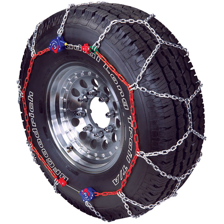

But if you want to have some so you can try to get down off a snowy mountain or off an iced up road in a true unexpected emergency, I have always liked the Z cables that zig zag across the tread, so there is always one part of a cable contacting the road. For vehicles with ABS they are recommended over conventional styles since they do not constantly "break traction". They call them Z-Chains for no reason that I can understand, but they are lightweight cables and very easy to store.
https://www.amazon.com/Security-Chain-SZ335-Passenger-Traction/dp/B000BR8UAE
I don't know which size would be needed for an Ollie.
You should put on two sets and back way off on the brake setting to avoid lockup. They will certainly help with stopping but they will also provide lateral grip to keep the trailer from sliding sideways in turns and on off-camber roads, and into the ditch or snow berm.
In winter I always carry two pairs of heavy duty truck chains in my tow vehicle. I have rarely needed them since I run snow tires, but they are there in case I get truly bogged down in snow or mud when I am far from help.
If I had to tow on snow, I would also put the chains on all four tires of the truck, for sure!
The z style is ok I guess but I usually go with the diamond pattern for a smoother ride. They are harder to put on cars because you have to roll and retighten but being that you can jack the Oliver up off of the ground, I'm thinking that they will go on easy enough and tight the first time. Chaining up is a way of life in some places and every car is different. I don't have a problem towing in chain control areas when needed but it's not something that I really prefer because there are too many others out there driving with no experience. Unless someone has a reason for me to not go with a low profile diamond pattern, I will be grabbing some this week for our next rally. There shouldn't be snow but there already has been a dusting the other day, and once it ices up, it looks like this year will be a cold one here.

In that case ride quality would be secondary to maximum traction and that means large chain links. It also means chains running diagonal or diamond or whatever to help with sideways slipping.  But, there's not a lot of clearance, so I don't know how much you can get away with.  The whole idea sucks.
I believe, in CA, if you chain up the truck you must chain the trailer too.

Exactly... You're going to want low profile. I'm not talking about getting out of a campsite, I'm talking about during chain control when there's not much of anything on the road as far as ice and snow. We pulled a friend's trailer home last year during the big flood, she didn't have chains, so I took the back road with light snow and had no problems, she was really happy to have her trailer back and it wasn't a big deal to tow it over the summit in the snow. That's when we were down by you guys last winter. I'm not wanting to put chains on to get out of a dirt camp site, just trying to obey the laws when they want me to chain up on the freeway or when dealing with ice. I have 2 snow plows and 2 snow blowers here at the house... I've driven in snow before and I even own real live snow shovels... I also used to have to park at the top of the hill and walk up to the car every morning during the winter but now I'm retired :)
