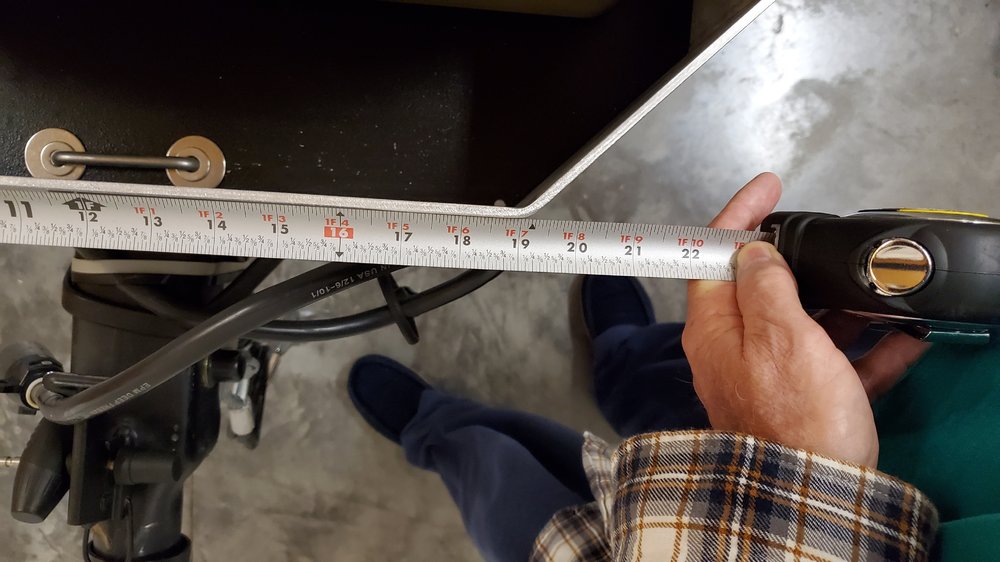

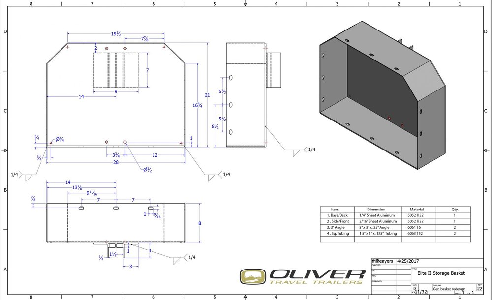

Again, I did some searching on this subject and found some discussions - one even including an attachment with the new basket dimensions.  Unfortunately, I couldn't get the attachment to open.
Since the basket is not rectangular, can someone tell me what is the maximum rectangular footprint (inside the angled corners) available in the new baskets?  (We're picking up our trailer 1 May).
Thanks, HOBO

Hobo, I think the failed attachment is on me - let me try again.
