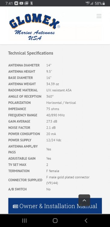

I missed your original post on this. A few things to consider:
The Shakespeare mount may not hold up on an RV installation. Best to check with their product support.
The Glomex line of omnis look nicer and have more robust mounts. These are popular with the go-fasts. I believe Hodges carries them.
Seems to me the Air360 is a good choice but it requires a second coax for the AM/FM antenna section. Course you'll also need an ethernet cable for the wifi option if  included. The footprint may cover the Kingdome mounting holes, making for a cleaner install.
Link to comment
Share on other sites
Thanks for that. The Glomex  mount looks much beefier than the Shakespeare.
Price isn't much different.  Hodges and others carry them.
As to the Air 360 (new version,) I'm not concerned about the number of wires. I think(?)  the kingdome already has 4, but we can always pull additional cable, since some are already there. I think it's (a) really big,, and somewhat ugly, and (b) we're unlikely to expand the capabilities with the inside units.
I'll look further at the glomex ranges, and reviews. I like the automatic gain control.
