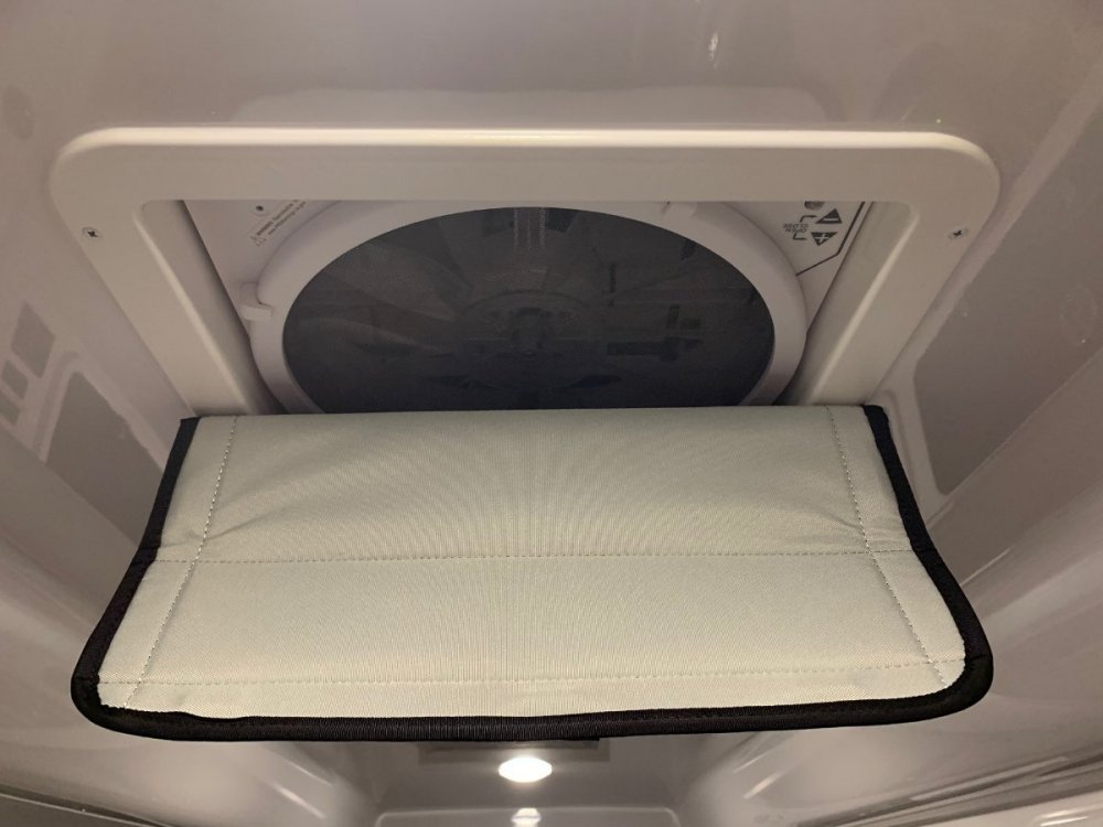

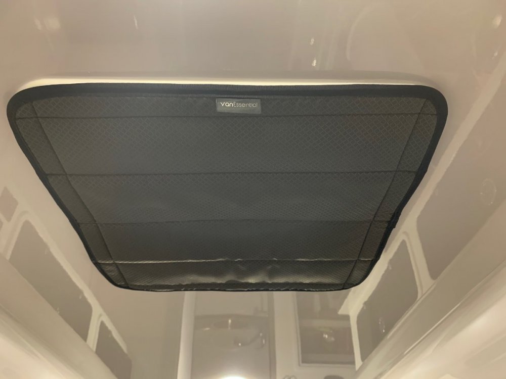

NCeagle Posted March 26, 2021 Posted March 26, 2021 (edited) In order to insulate AND black out light that enters through the Maxxfan, I ordered this: VanEssential Magnetic Insulated Roof Vent Sun Cover for MaxxAir Fan, Fantastic Fan - Olive Gray It's not the cheapest one out there, but I like it because it completely blacks out the Fan, it's insulated and the installation is superior to other products I saw out there (hidden magnets vs velcro). This one takes a bit more work to install as you have to remove the inside trim on the fan (which is caulked), install / tape magnets to the inside of the trim, and replace the trim (and re-caulk). So all in all it took me about 2 hours. The magnets work great and reviews say that they work much better than velcro, which has a tendency to tear free from the trim and leave a glue mess behind, especially with heated trim. Here's a picture of the final product: Edited March 26, 2021 by NCeagle fixed typo 8 2020 Elite II, Hull 688 --- 2021 Silverado 2500HD, 6.6L Duramax Diesel
