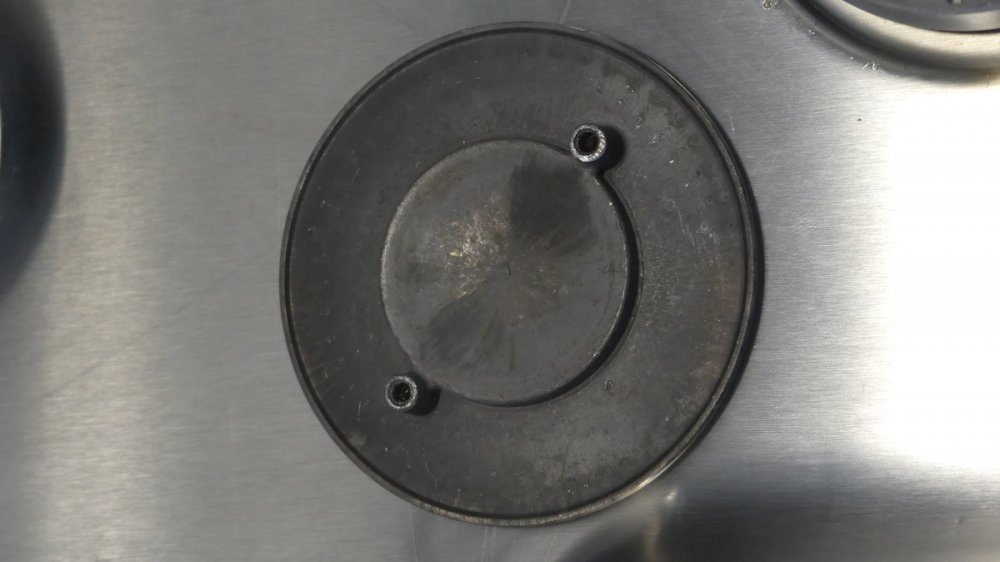

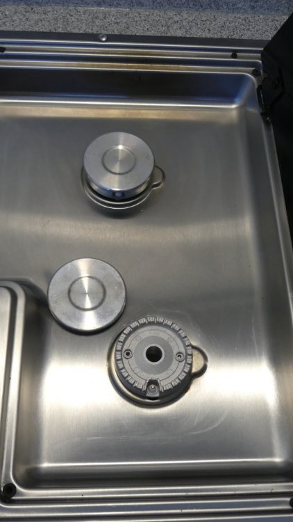

Question for those with the new Dometic cooktop (2021 installations) with the cast iron grid:
The burner assembly (top plate and base it rests on) came loose.  Is this normal?  Nothing appears to be broken.
There are two pins that fit into holes in the bottom of the cooktop, but I can find no way to lock the burner back in place; the rear burner is snuggly attached.  I don't want to call Oliver or Dometic until I find out if there is an easy solution.

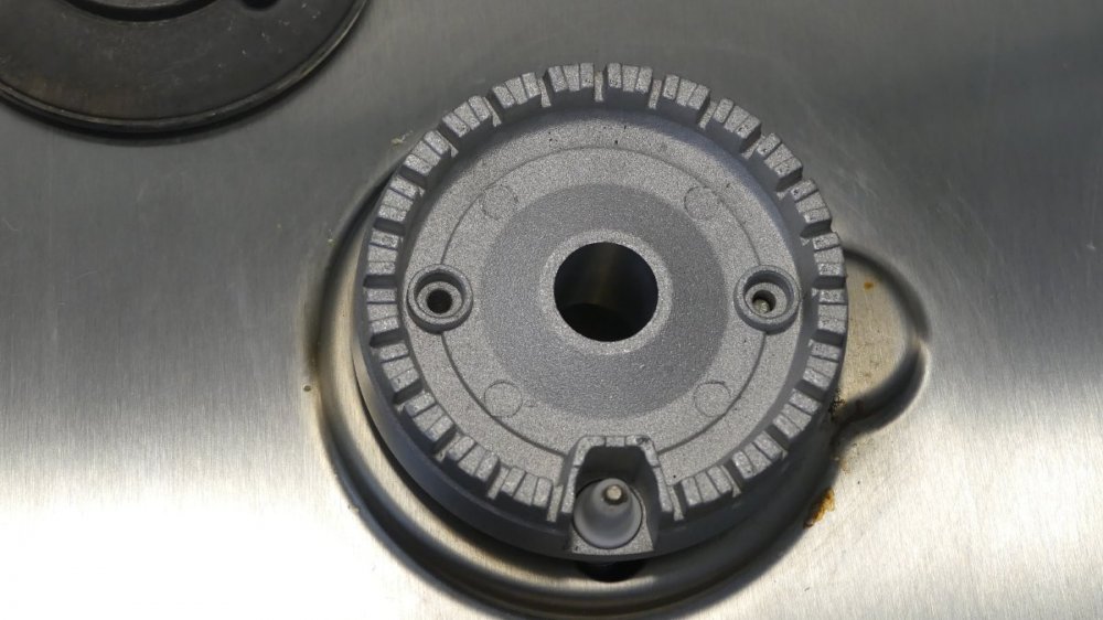

What came loose? Just the top? (2) or the spreader beneath? (1)
My smev is attached though the canceling cap (2), with screws , so not like yours.
If the spreader (1) came loose, I'd start a service ticket. It should not come loose, and the assembly should be attached to the lp line under the cooktop, I'm thinking.
I poked around trying to find a service manual for your model, and came up empty handed. I'm thinking its kind of like my smev,  and there's a gas jet in the center hole.

Both pieces are loose.  I wouldn't worry so much about the top; but, as you mention, the bottom being loose might morph into an issue with the gas supply.
I do believe the gas jet is in the center . . . . that's the way our home gas cooktop is, with similar spreader, though it just sits on the top with ears that match up with slots.
I will initiate a service ticket and see what transpires.

If your burner is like my smev, the pieces you've shown don't actually carry any fuel. There's a little gas jet, attached to a fixed gas tube, that supplies the fuel. It looks like a small, thin brass nut. (Mine is 11 mm, I think.)
The alloy base plate with the ridges supplies air to the jet,  "spreading " the flames. My guess is the base plate is attached by a couple of machine screws from the bottom, meaning you'd have to remove the cooktop to reattach it, like the small burner.
The stainless steel cap is not fixed on yours. Mine is held on by old, stubborn, corroded and stripped screws.

There is an attachment to the base for the striker, which I assume is connected to 12v power.
It's a mystery that the top plate is not attached because it is on the burner that is firmly affixed.  Not sure if something popped loose or what; have yet to look under the stove to explore.  This is minor, except it is free to move about during transit which might not be a good thing.  At any rate, a new stove shouldn't break in a few short months of use.  Someone needs to build more durable RV appliances, rather than cheaply made disposable ones, but that's not likely 😠

I think you probably have a little blade electrical connection for the piezo igniter. That needs to be lined up.
If you can use a flashlight and mirror to see if the gas tube and jet haven't moved, you're probably good to go.
The gas tube and jet are the only gas supplies. The alloy base and cap are useful,  but just sit around and on top of the jet.
