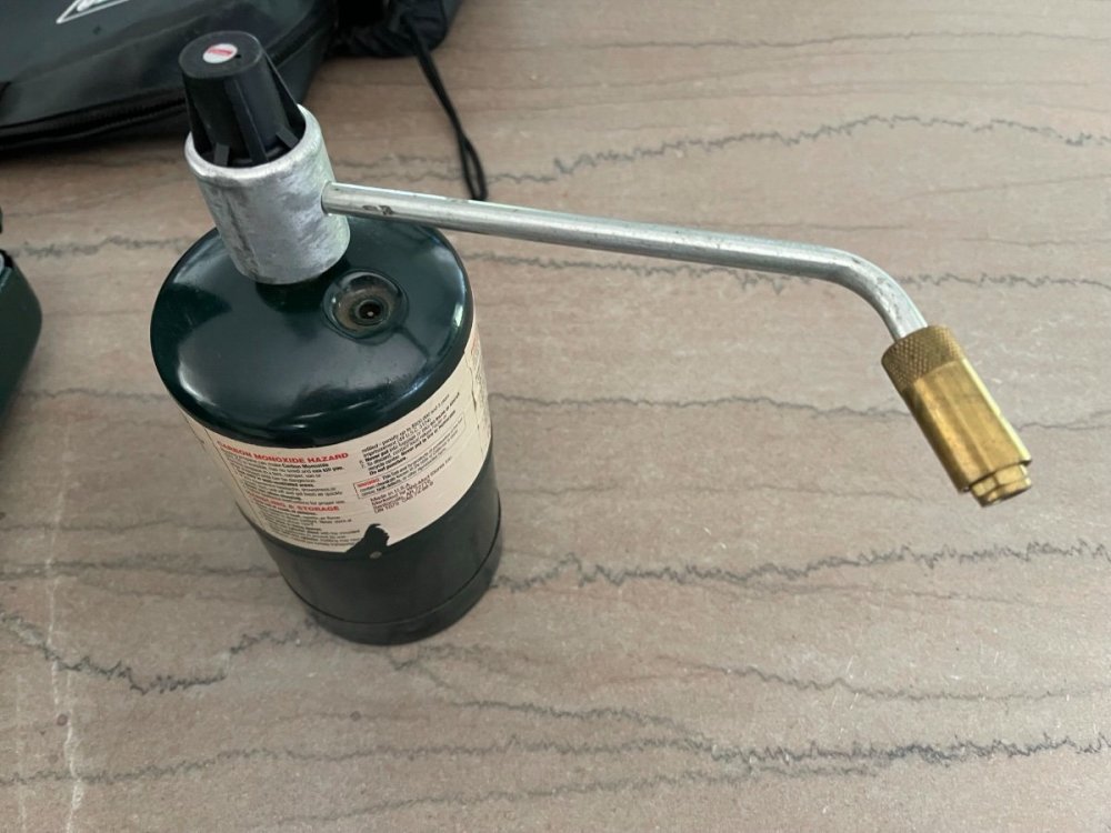

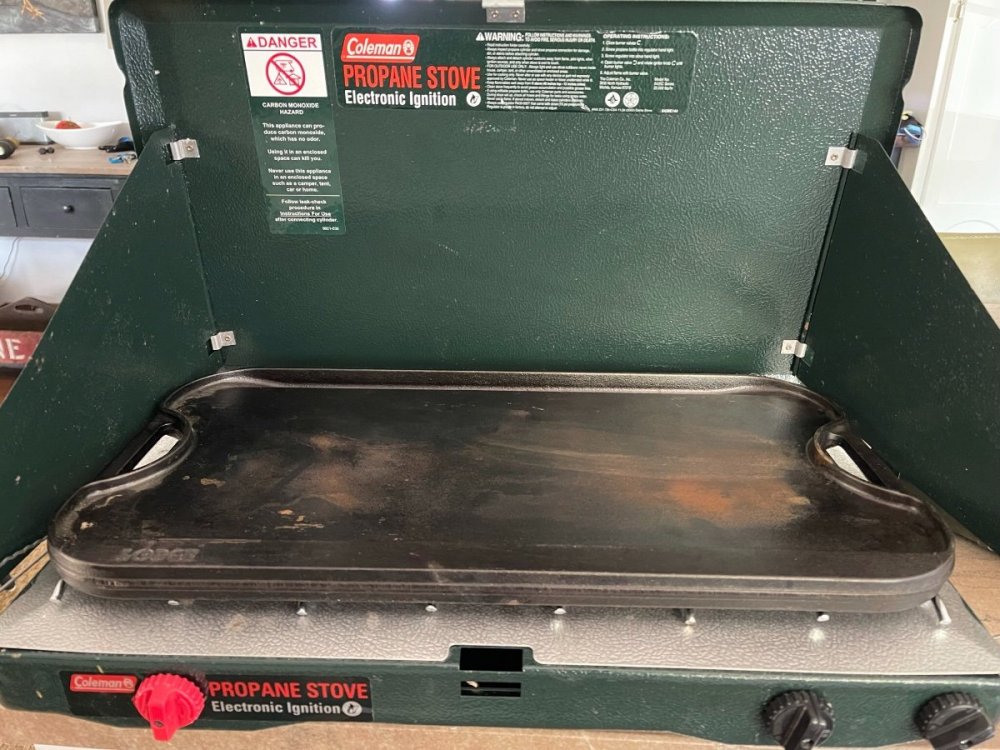

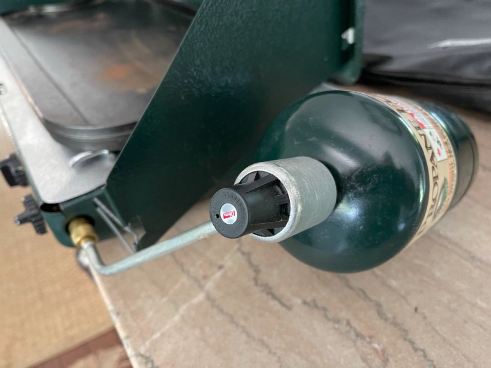

John Dehne Posted August 24, 2021 Share Posted August 24, 2021 Hello all, Has any one converted a Coleman Perfectflow stove to run off the low press connection from the Oliver. Had this stove for years it’s my cheep Blackstone grill. Thinking about cutting off the stoves regulator and inserting into a 1/4” ID gas hose with hose clamp. Thanks in Advance. John & Chris Dehne Manchester, MD. 2021 Elite II twin Hull# 901 “Fiberbeergrass” 2021 Ram 2500 Cummins 4x4 Life is good! Link to comment Share on other sites More sharing options...
Townesw Posted August 24, 2021 Share Posted August 24, 2021 From what I’ve read Coleman propane stoves operate off about 15 psi. The low pressure from your trailer quick connect is about 10 inches WC which is about 0.36 psi. 1 Bill and Martha 2018 LEII Hull 313 2019 Chevrolet 2500HD Duramax Link to comment Share on other sites More sharing options...
