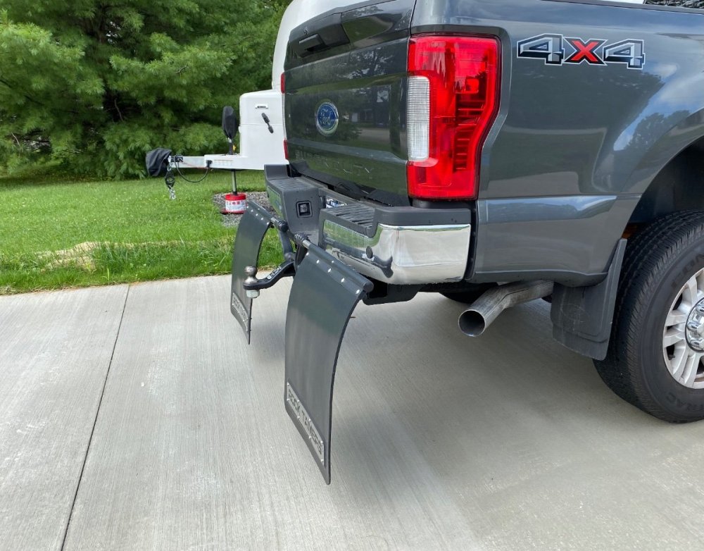

I’ve had the RockTamers on all of my tow vehicles.  Our first tow vehicle was a Ford Expedition that had the exhaust pointing straight back under the rear bumper.   I installed the optional heat shield that RockTamer sells (see first photo) and it helped a bit, but the rubber behind and around the heat shield STILL showed signs of overheating and partially melting.  The Expedition is gone now, currently towing with an F-250 and the exhaust points out sideways behind the rear tire (second photo) so no more heat shield now (and I did put on a brand new rubber mud flap), and no problems.    I’d recommend seeing if you can have a muffler shop fabricate a curved tail pipe section so the exhaust is out to the side away from the mud flap.
I agree with FrankC. I would remove the chrome tip and install a short angled (downturned) tip. Or a 90 degree one exiting to the side. Problem solved. Don’t over-think this. Rather than trying to correct the problem (melted rubber), eliminate the root cause of it.
