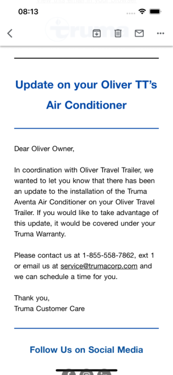

Hello,
Is anyone aware of what this pertains to?
Thanks, Kirk
I believe that’s the update involving longer screws and sealant to cover the holes above these screws on the top of the AC to eliminate water leaking/intrusion.

Hello,
Thanks, Kirk
I too would like to hear an explanation of this email. Sounds kind of important.

Yes, I agree 💯, thanks for posting this up the links. I learned at service Oliver is already addressing this to hopefully preempt any further concerns.

I spoke with a very nice Truma rep this morning. Here is her reply to @Snake River Idaho post.
If the customer reaches out and states they had  “self levelling sealer” installed by Oliver directly, then they have already had the update done and do not need to pursue any additional updates.

Thanks for all of the replies!
I guess I will call Oliver and ask about our trailer, since we have one of the first production line trailers with the Truma package.
