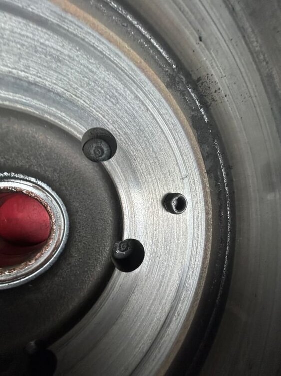

This mystery has been solved. A tech removed a loose nut from inside the offending wheel drum today. It was a brake backing plate nut, but all the nuts were in place as they should be, so it must have been an extra dropped into the wheel assembly at the Dexter factory. It was intermittent and wasn't found sooner because it would stick to the brake magnet and hide.
