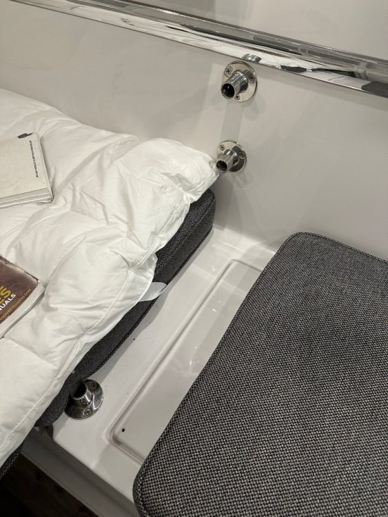

In my tweaks to my 2021 LE1, I’ve removed the rail between the front dinette seat and the rear seat/bed. This has given us much appreciated added headroom in the double bed for whoever sleeps closest to the bathroom.
The rails came out of their base brackets with a little wiggling and stretching, but the brackets won’t come out. I removed the nuts from the lowest bracket easily enough, and expected the base brackets to come right off. They don’t budge, and I am reticent to force them.
Are they glued?  Any ideas how to get them off without doing violence to the fiberglass?
I can live with them if need be.

Those screws are backed up by nuts? The only thing I would guess would be glue in addition. I don't think they would have needed screws and glue. Additionally I can't see any way to place the two upper brackets unless it was done pre-assembly and I don't think they would have done it that way.
I got the front one out. I used a hammer drill to screw the bolts out (I couldn't budge them by hand). One seemed glued and two came out easily. I took a spackling knife and lightly tapped around the edges flat against the fiberglass, hoping to pop it off. It did come off, but with a little fiberglass damage - from some glue that was used?  See the photos.
I can put it back easily enough, but if the wall mounts are installed the same way (with bolts and nuts), I'd never get them back into place if I even managed to get the bolts out. I think I'll leave them alone.

Too late now, but heat may have helped. Could have been epoxy, could have been a 3m product.
You can "seal" that raw opening area  with gelcoat (Ask over for the color number), or just use marine tex. It won't be a super close match, but it's under cushions anyway. Get the bright white if you go marine tex route. Use saran wrap to cover after application. Look up some youtubes. Lots of good ones out there.
At the very least, cover with an adhesive patch, or even white duct tape, to keep moisture out, and save friction on the cushions.

I think I saw your recommendation of Marine Tex in another post, watched a good video and got myself a tube - to fill the holes of my previous camera mount.  Will use it here also since it’s hidden. Thanks for the details.
Hadn’t even thought of heat!

Do use the saran wrap. It will smooth the edges. That's all you are really needing in a hidden locations.
