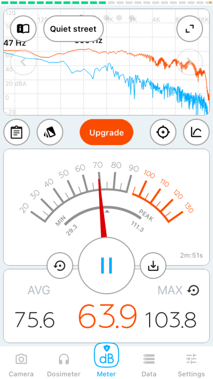

Not sure how accurate sound noise (dB) measurement apps are? I just downloaded one. However, when using any tool, carefully in the same manner, it should show a reasonable relative comparison.
The new water pump was at 50 dB (pretty quiet!).  I closed the basement door to the water pump, placed a 4" dinette seat to cover the opening and placed the phone on the seat cushion, showed 50 dB. I went into the bathroom, ran the water holding the phone down below the sink to measure the noise within vs. the water pouring, it was 73 dB.
Lastly, I started our older Dodge Ram Cummins, on a colder day and ran the app while idling. The 2nd Gen Dodge Cummins are noisy, not like the older Ford PowerStroke, but certainly noisy! It came in at 64 dB.
Conclusion, the plumbing under the bathroom sink in our older Oliver is louder than an old Dodge Cummins diesel on a cold start! That's really bad.

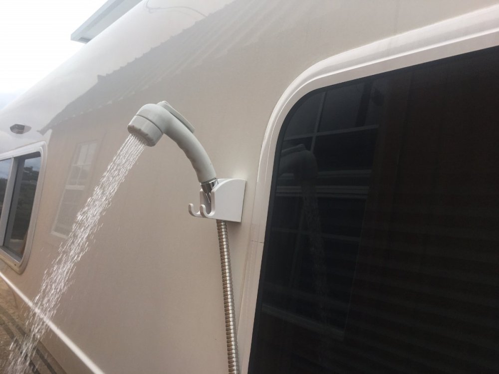

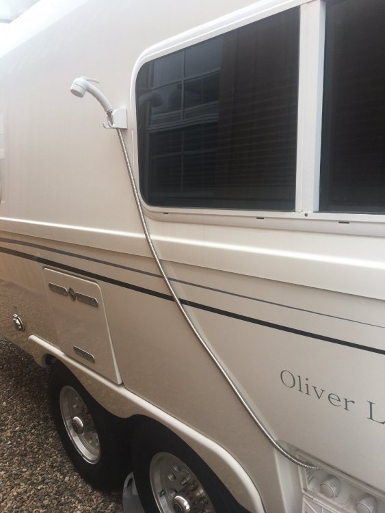

My final water upgrade, a cute minor addition! I never was much for RV outdoor showers but given the Oliver wet bath they seem more viable, when at times not wanting to get everything inside wet. Problem is you got to hold the shower head, making it difficult to take a quick shower. So, I wanted a holder for the shower head and found these:
JONKEAN White Handheld Shower Head Holder with 2 Hanger Hooks, Strong Adhesive Shower Head Holder, Adjustable Shower Wand Holder Wall Mount, Bathroom Waterproof Shower Handle Holder No Drill Need - Amazon.com
Comes as a 2-pack. Being 6' 2" I mounted one as high as the shower cord could extend. The second one will be down below for our dog wash! You only have to leave the clear mounting plate on the Oliver and the holder itself fits behind the outdoor shower door with the shower head. With the new water pump, the stream is now so much better!
