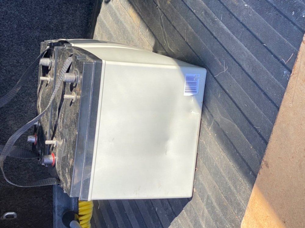

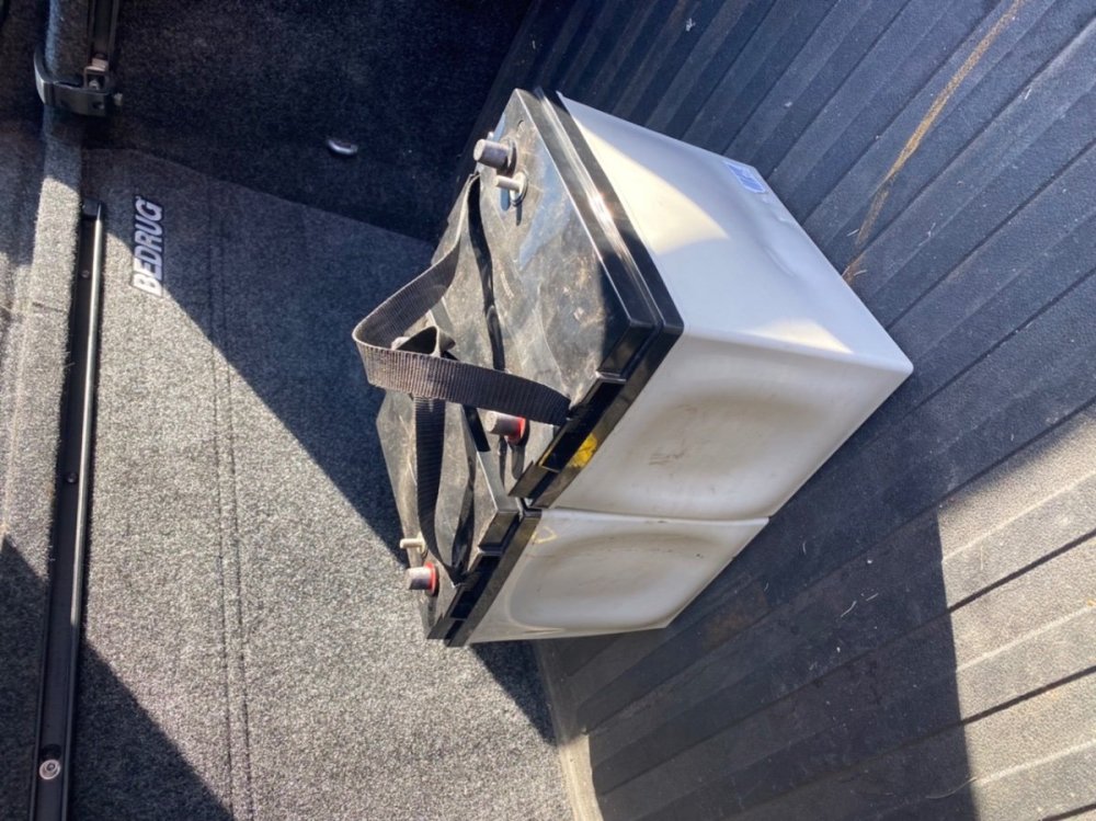

Yes! Photos don’t do the reality justice. The 2 batteries ARE fused together. Am glad it wasn’t all four! -

Okay! The batteries are removed! Two of those lunkers were fused together, a 140 pound mass that was worth something, just months ago! Thanks everyone for the advice. You're the best! -

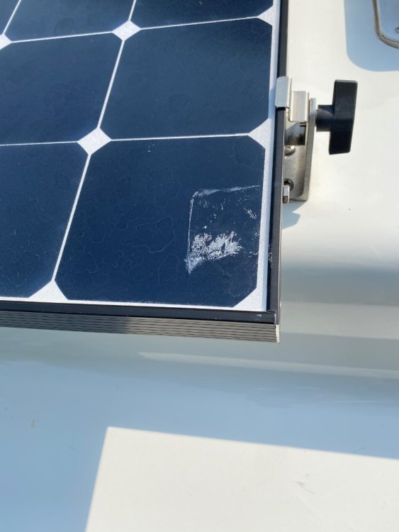

Well, thanks everyone for your great advice! The adhesive melted in the WD40 while I went for a walk, and I gently wiped the mess away when I got back. Neat to learn such an easy solution. You are the best! Mary -
Somehow while keeping the Ollie under a cover we got duct tape adhesive on a solar panel, and I'm wondering how to safely remove the adhesive. Would using GooBeGone be a reasonable choice? Thanks for the help!
