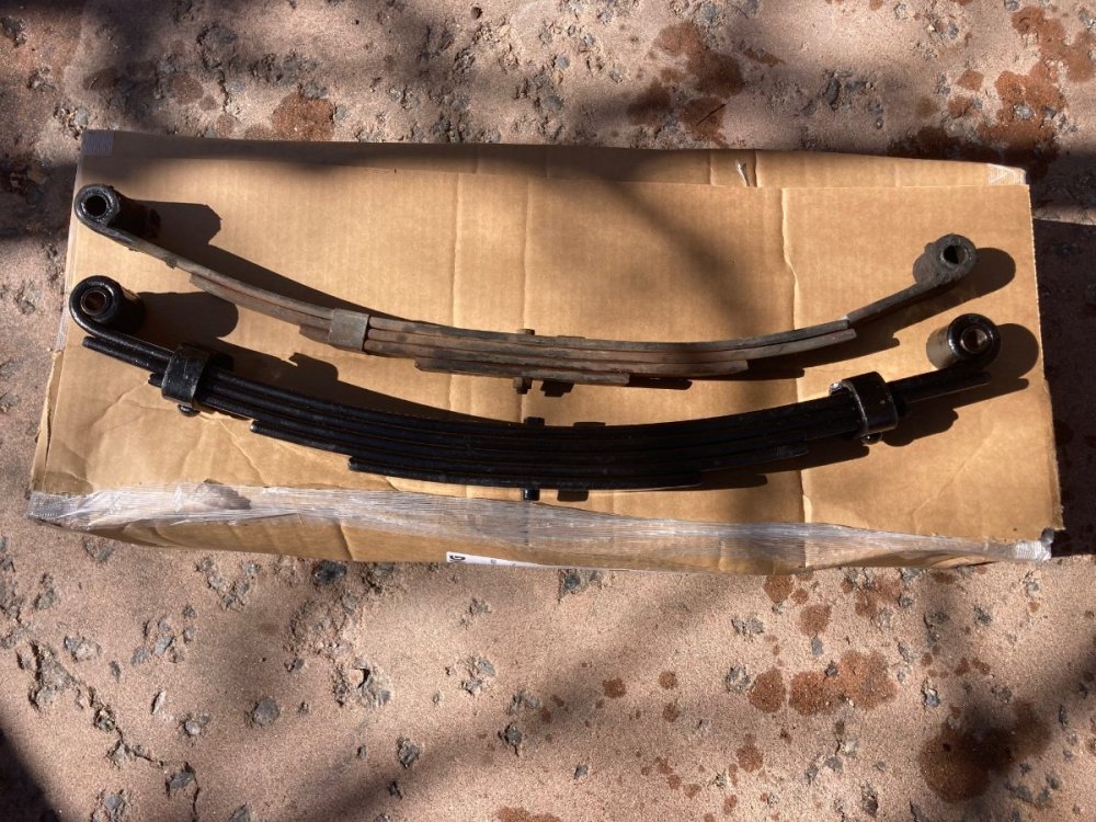

Mine were 1/2”x3” and the new ubolts provided by Alcan were 9/16”x3”. Fit perfect. Longer to accommodate taller Alcan spring packs. 9/16” fit thru spring retainer plates fine as holes are larger than 1/2” -

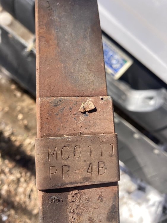

I think the answer you got is technically correct, but I do not believe the axle assemblies provided to Oliver by Dexter contain spring packs manufactured by the Dexter Parent company. For example, the springs on my trailer were stamped “EMCO”. If you do a google search you will find that while EMCO is a US based company, they have a 200,000 sq ft Spring plant in the Hebei Province in China which serves the US market. At least for my trailer, I am fairly certain this was the manufacturing plant for my Springs. https://emcoind.com/about-us/ -

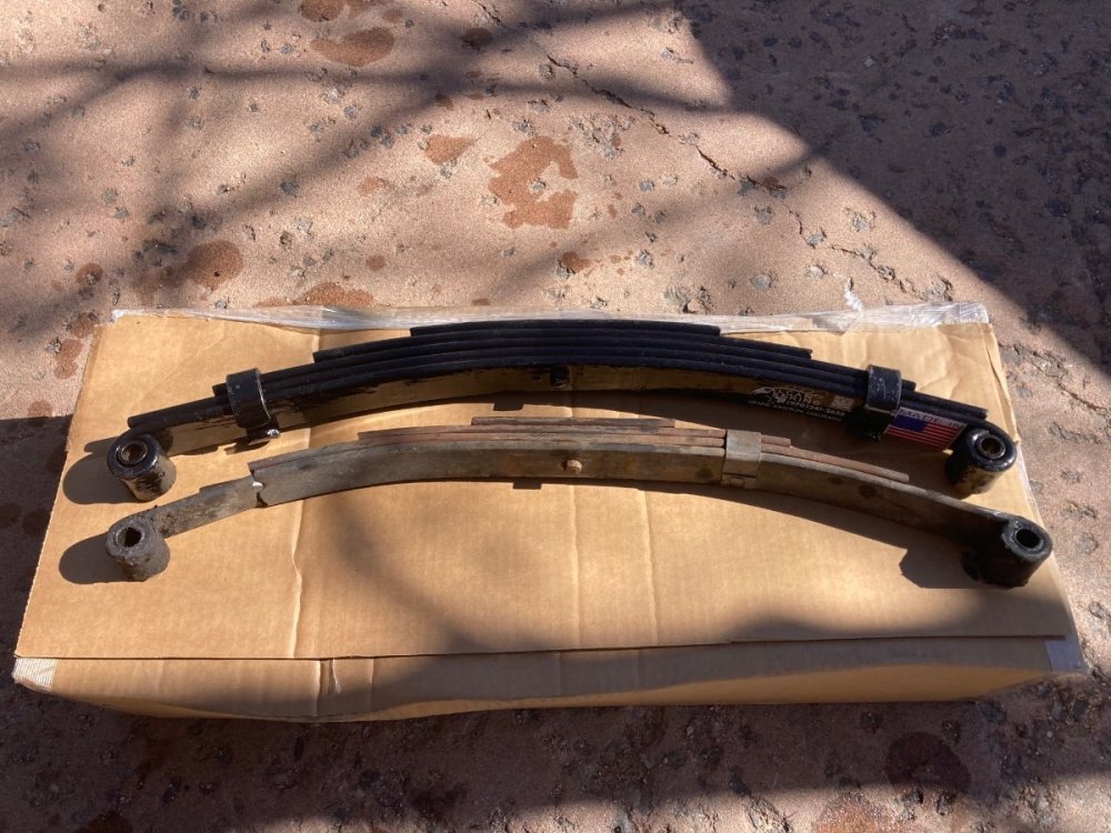

First side is swapped. Old Chinese Dexters will go to the recycler and bring scrap value…maybe enough for a soda pop. A few observations: 1) I put a set of calipers to my 3500# Dexter axles and they are 3” dia. Ubolts provided by Alcan are for 3” dia axles fit perfect 2) Alcan ubolts are 9/16” rod vs. the smaller (1/2”?) that were stock on my trailer. No worries installing as the holes in the spring retainer plate are large enough to accommodate the larger bolt diameter 3) Alcan ubolts are longer to accommodate increased spring pack height (5 vs. 4 leafs). About 1-1.5” of thread extend below nuts. I plan to leave but you could cut the excess off if it bothers you 4) Torque specs from Alcan for 9/16 ubolts is 90 foot lbs. See attachment 5) Two of my shocks were blown so I am replacing them A Irwin squeeze clamp works wonders for compressing and installing the shocks after the springs have been bolted in 6)reversed the wet bolts so that the zerks point inward even with a 90 degree lock-n-lube fitting it was a PITA before hoping this will be easier 7) the front springs were still in “ok” shape but starting to flatten. one rear spring had snapped and the other was bent 8)the parts for my trailer were sourced during COVID and at the height of demand for RVs. I cannot help but ponder if the RV frenzy and skilled labor shortage during this time played some role in my broken spring and the quality of the other one that was bending. Oh well, just glad to be safe and be replacing the stock springs before heading out in a month for another Season of seeing this great Country Very straight forward swap. Heck, I did it on a tarp in melting CO permafrost. Cannot imagine doing the swap inside on concrete. 🤪 That would be Lux. -

Mike from ALCAN just called to let me know that all future orders of springs for Olivers will have the centering pins in the correct orientation for our trailers. He asked that I alert those who have ordered and who may order in the future to state the springs are for a Oliver E2. I had sent him an email asking about my understanding of how to flip the centering pins on my springs. He confirmed that flipping the pins is as simple as MountainOliver explains with a couple of C clamps, wrench, and hammer. Hopefully, I am the only Oliver owner to have to perform this step moving forward. -

I can confirm that these measurements match the OEM brand/model spring specs for Hull #898 as well as match the published specs for the replacements spring brand/model provided by Oliver Service for my trailer. I encourage owners to confirm the specs of their OEM springs to know what they are replacing before proceeding with replacement of any part as we know certain differences exist between out trailers based in hull# and date produced. My OEM Spring make/model was conveniently stamped into the retainer band towards the end of each of my leaf springs (see pic). From this info I did a google search and found the specs. The springs installed at the factory on Hull #898 were made by EMCO and are model #PR-4B. The specs match what Steve provided above. Added to the specs Steve provided is the bushing spec provided by Oliver. The bushing is inserted into the spring eye and our wet bolts ride inside of them. The specs for these bushings (whether plastic or bronze) is 1.75”L, 11/16 O.D.(outside diameter) and 9/16”I.D.(inside diameter). It should be noted that the bronze bushing on the ALCAN springs is thicker walled than standard such that while it still has a 9/16”I.D., the spring eye into which it is pressed is larger than 11/16”. The 9/16”I.D. Of the bushing is important on these metrics as our wet bolts (which are 9/16” must fit inside the bushing eye) I hope this makes sense. I have attached a pic for comparison OEM spring in top, ALCAN on bottom.- 948 replies
