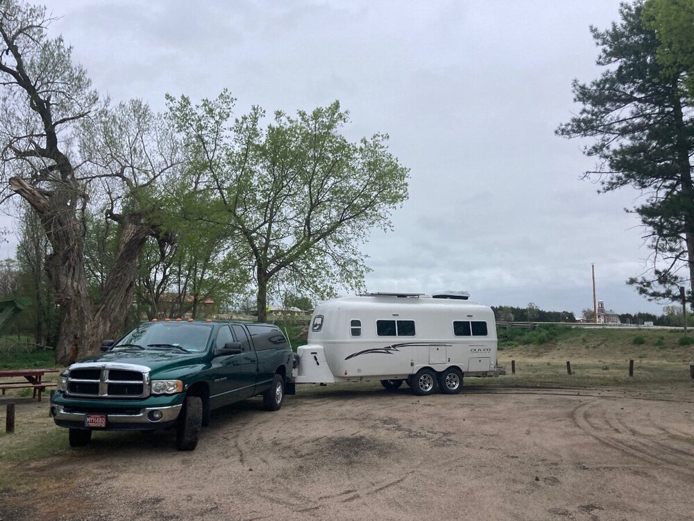

Found this little roadside park and free campground on iOverlander while driving across Kansas on US36. The sign in the park says overnights are welcome… and free, unless you need electricity, then it is $15/nt using the self-pay box. There is potable water available. While it is next to the highway, overnight was extremely quiet. Awoke to two deer grazing near the trailer and the sound of songbirds. Highly recommend this spot if you are on US36 near Kensington, KS. For a moment I felt transported back in time to the 1930s/40s when roadside camping on US highways was commonly practiced by Families making their was across the Country. US36 takes you past the geographic center-point of the US and not too far from the worlds largest ball of Sisal twine (my cat was pawing at the window to get out and try his best to play with it).
