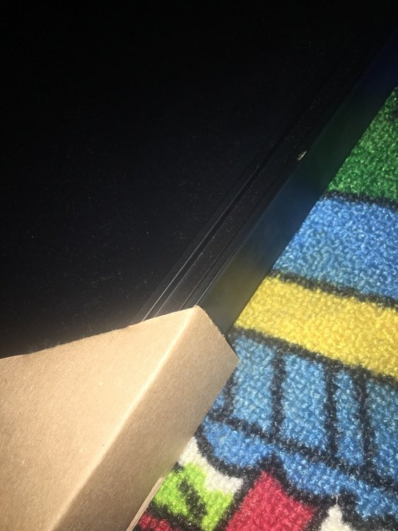

  4. If I’m seeing the pictures correctly, it looks like Oliver is ignoring the use of the Zamp rails and just through-bolting the panels like they did on the older Legacy panels.

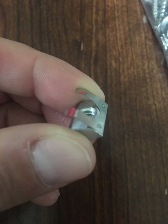

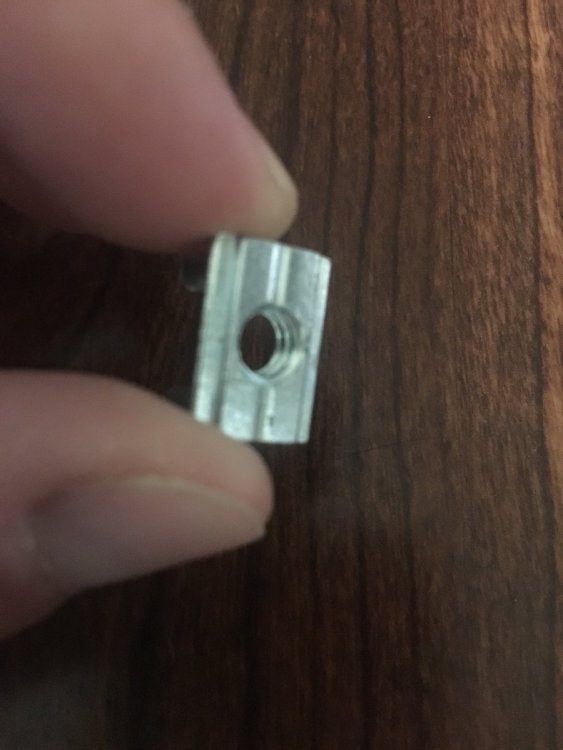

  5. Those rails require special nuts with springs attached to them to use those rails:

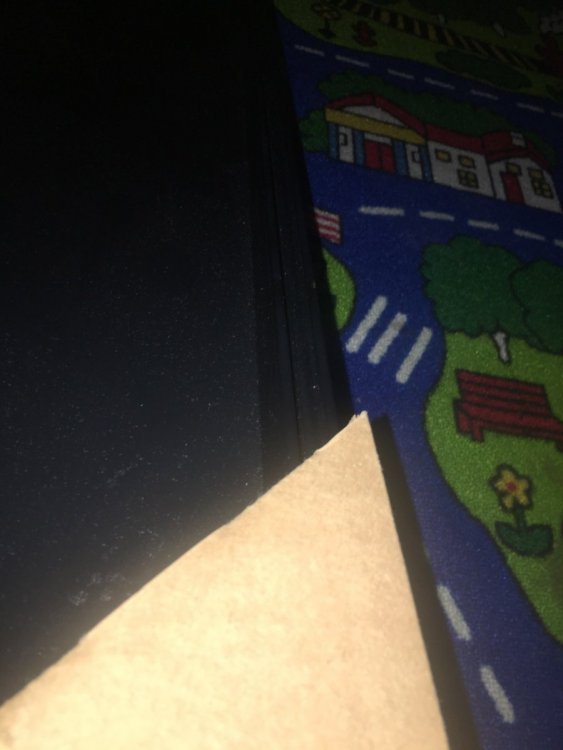

  6. Thank you much for the pictures! I kept getting thrown off by the new rails on the Zamp solar panels. See below:
