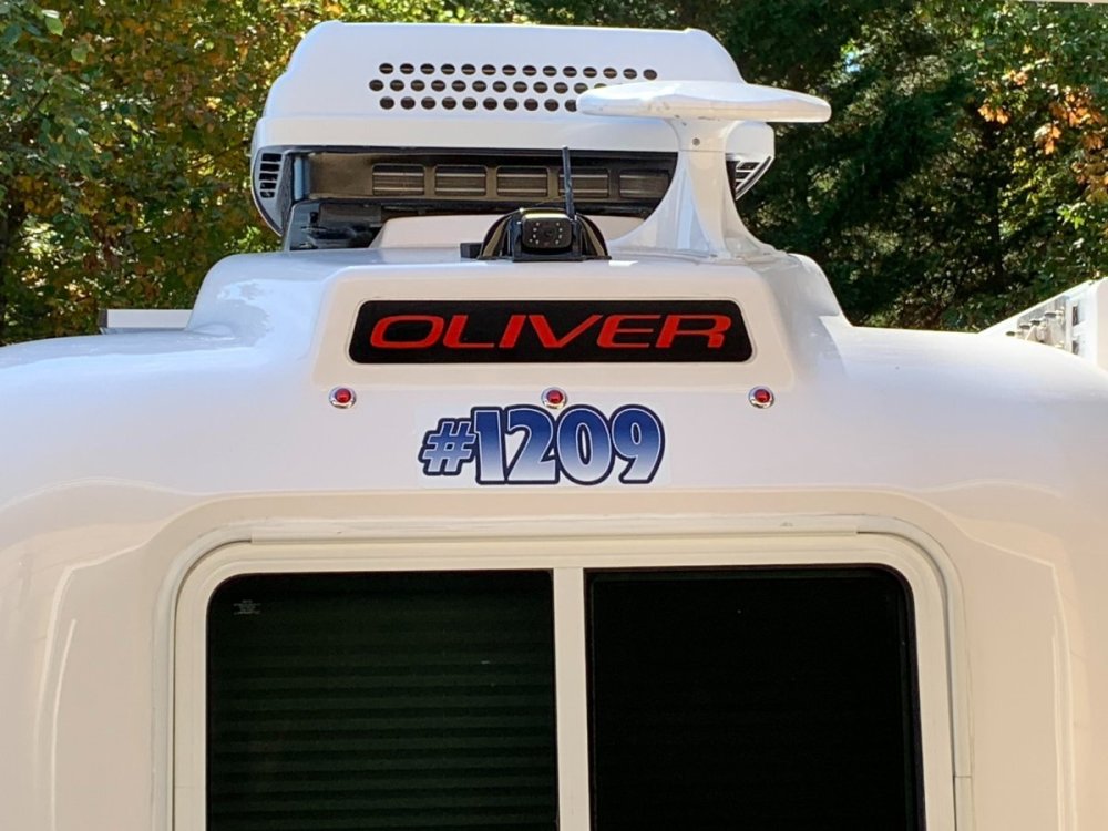

Thanks to Landrover's recommendation, I used his friend Bob Hardbarger to develop graphics for Li'l Ollie. I emailed him some artwork of the TN flag and some of our East TN/ Western NC mountain scenes and he combined. He was very reasonable, as I have had logos developed and graphics for my previous business. He got the larger graphic to me just before my August 11 delivery and the young lady at Oliver, who applies their graphics, put it on for me during her lunch hour, and showed me how to apply the Hull number that I had him do later. I understand that he is retired but continues to do some work.
