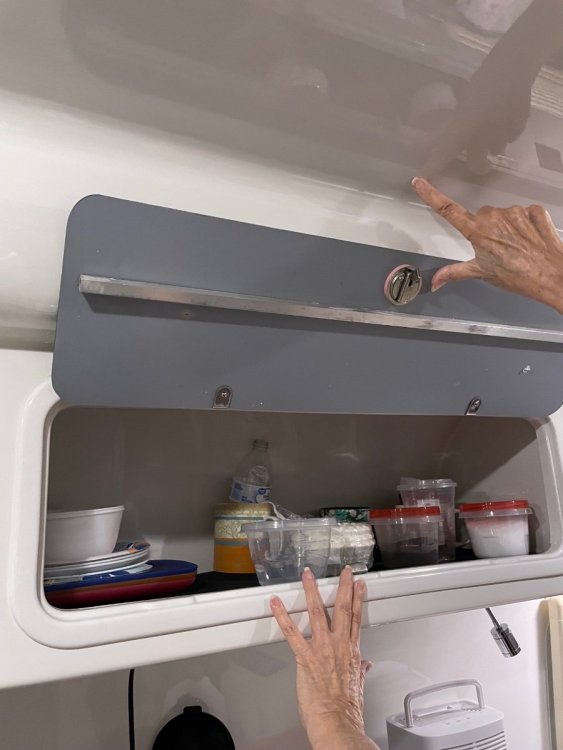

  1. A couple of months ago I posted about wanting to flip the cabinet door above where the coffee pot is. It's finally done (almost). Every step was a two person job. Three wonderful people helped me. I dragged my feet a bit because, honestly, I loved having it open. But it was a pain when moving. Scrapped the old calking and glue off with plastic blades. Cleaned off lingering stuff with acetone. Removed the door from the frame. Flipped the frame upside down and glued it back on using 3M 4000 adhesive. Note, the frame is flexible and wanted to sag, getting it right was tough. The door fits tighter than I'd like but it closes. Screwed the door back on. What a pain. Tiny little screws that aren't magnetic and there is nothing to brace the door on while trying to get the screws started. Because of the curve of the ceiling, the hook had to be placed out aways. Right now it's just being kept open with a couple of bent paperclips until I figure out what's best to use. Here's the finished product:

  2. I had to get out the tape measure for this one. The height of the top of the door is 5'10", plenty of clearance for me (5'7 ½") but a problem for taller folks. I thought the ceiling would stop it from going much higher but when we held the door up, it had plenty of clearance. Looks like it's back to the drawing board. In the photo, my index finger is pointing to where a hook would go on the ceiling.

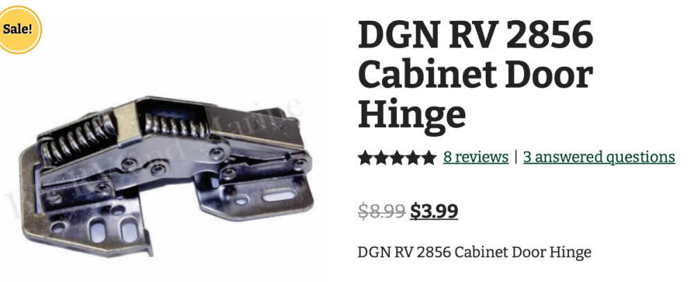

  3. I've tracked down the hinge that was used on my old trailer. Ideally, this is the hinge I'd like to use. (Or try to use). https://rvandmarine.com/product/dgn-rv-2856-cabinet-door-hinge/
  4. My coffee pot is just under the cupboard and my coffee supplies (coffee, sweetener, cups, filters) are in the cupboard, so the door is right in my face when I'm making coffee. (Yes, I'm serious about my coffee). In the trailer I had before the Oliver all of the cupboard doors opened upwards and I loved it. It's the only trailer I've had that I never hit my head on.

  7. I've pretty well given up on a hinge, and will attach a hook to the ceiling and a chain to the latch.

  11. The command strip would absolutely be suited to hang the door from. I already have a hook that I'll use, or at least start out with. It's one of those suction things. Bigger and more intrusive to the eye than a command strip, but on hand.
