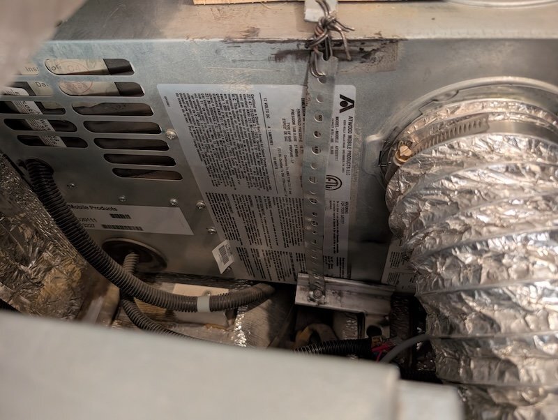

Probably not. I'm not seeing that control board easily available for less than $150. If I happen to come across one for cheap I may pick it up though. My research shows it's Dometic part number 3312022.000 If I can't find it cheap, then I may pull the Micro Air out of it and motor and shelf them or sell them off separately. -

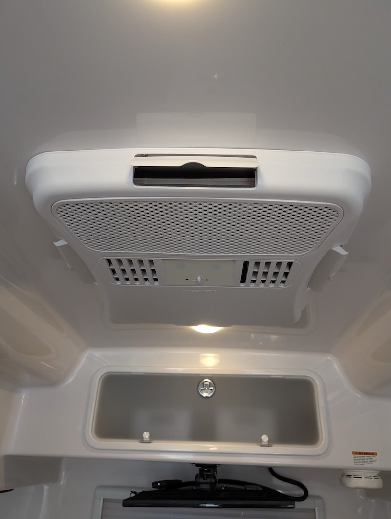

Going to update the AC unit with a Tosot
ChristianD replied to ChristianD's topic in Ollie Modifications

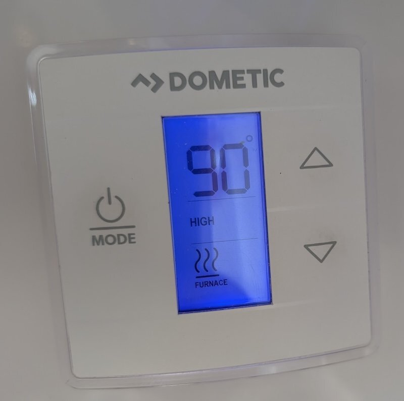

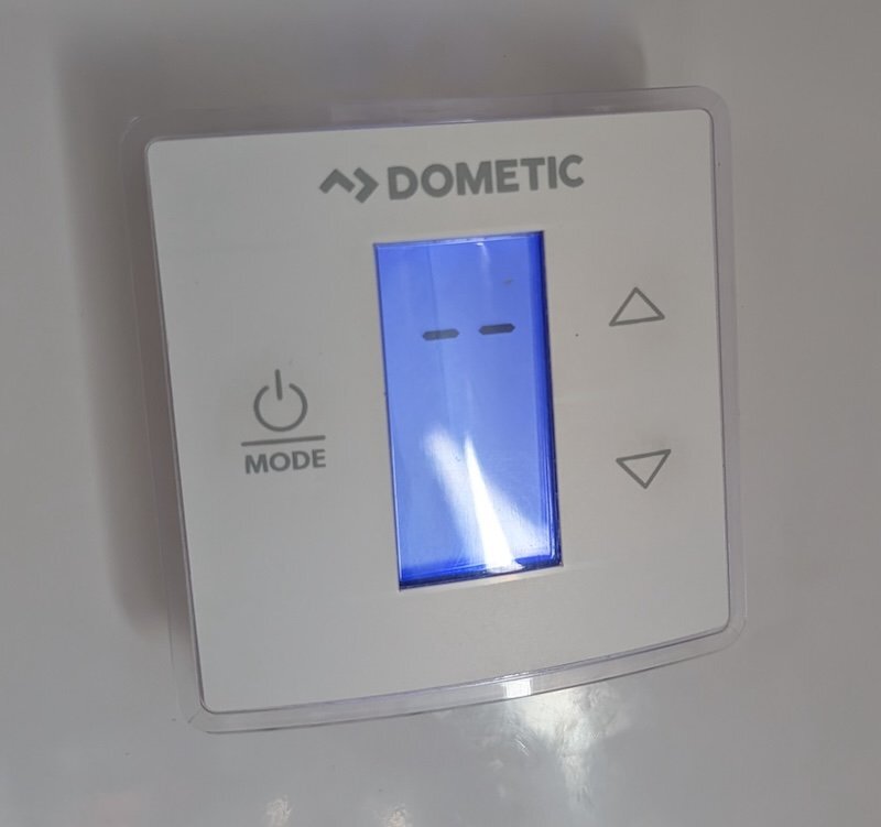

✅ Successful Furnace + CT Thermostat Integration After A/C Swap (Tosot Unit) Hi all — following up on my earlier post where I mentioned trying the Dometic controller from RV Surplus. Turns out that board was not the correct one for our Oliver furnace setup, and it would not communicate with the Dometic CT thermostat (kept throwing E1 code (no communications with the board). TL;DR: If you replace the factory Dometic A/C (mine is now a Tosot), the only way I found to keep using the Dometic CT thermostat to control the Suburban furnace is to reuse the original Dometic control board from the roof A/C. The CT thermostat did not run the furnace without that board in the circuit. 🚫 The Wrong Part I Initially Ordered I'd edit my previous post about this part, but I don't appear to have edit access to my older post. For clarity, the controller I first tried — which did not work — was: Dometic™ OEM 3316230.700 (9600024570) / 3313199.000 Single Zone CT Thermostat w/ Control Board (Cool/Furnace) – White Even though it says Cool/Furnace, this is a Single-Zone CT control board, not the CCC2-style logic board used in the Oliver. It will not communicate with the Oliver’s Dometic CT thermostat → results in E1 error. This board also lacks the correct communication architecture that the Oliver’s factory wiring uses. So if you're replacing your original Dometic roof A/C with a Tosot and want to keep your CT thermostat to run the Suburban furnace, this part will not solve it. I only had success after re-using the real factory control board pulled from the original rooftop A/C. ❌ What did not work Purchased a Dometic “furnace controller” from RV Surplus Installed and wired it per previous guidance CT thermostat would not see it → E1 comm fault That part was a standalone freeze/temp sensor board and not the actual Dometic furnace logic board the CT needs to handshake with. At least that's my understanding of why it wasn't communicating and turning on the furnace. ✅ What did work Removed the original Dometic control board from the old rooftop A/C unit Installed it in the ceiling cavity where the wiring drops down Connected the original Oliver comm wires (blue/white) and 12V power leads; basically connected all the wires I cut back to the wires on the original control board. Connected the furnace R/W from the Dometic board to the Suburban furnace leads Plugged in the original Dometic freeze sensor (or you can use a 10k resistor) to avoid E5 Thermostat rebooted, initialized properly, and now Heat mode functions just like factory. The Tosot A/C runs stand-alone on its own remote — the CT thermostat now just handles the furnace. 🔧 Mounting Notes There was no enclosure around the board in the original AC, so I repurposed the housing from the incorrect RV Surplus controller. Trimmed two corners of the board to fit and secured all wiring. Everything is clean and protected behind the interior ceiling shroud. 🎉 Result CT thermostat works in Furnace mode No more E1 or E5 errors Oliver interior remains OEM-clean — no separate thermostat needed Tosot A/C runs independently on its own control system 💡 For others doing a swap: If you want to retain your CT thermostat for furnace control: Do not discard the original Dometic A/C control board. It must be reinstalled to act as the furnace interface. The Oliver wiring uses the Dometic bus — not simple furnace contacts — so the board is required for the CT to communicate. Thanks to @RonBrink and others who paved the way on this mod — his wiring was slightly different, so I'm sharing this as a variation in case it helps the next person who uses a Tosot (or any non-Dometic) replacement A/C. Pics attached below. Let me know if anyone wants a wiring diagram or parts notes. -
I found the issue with the generators now working. My Honda generators have a "floating neutral" and the Tosot won't power on without the neutral grounded. I made a plug that jumps the neutral (silver side) to ground and plugged in the regular plug, plugged into the rv, fired up the generator and the AC powered on! Both my Honda EU2000 and 3000 work with it like that. Solution: Ground / Bonding Plug Some RV A/C units + soft starts will NOT start from an unbonded generator (floating neutral). They see it as a fault and won't engage the compressor. Honda portables = floating neutral Fix: Use a neutral-ground bonding plug in a spare outlet on the generator. Example DIY bond plug: Standard 3-prong plug Jumper neutral to ground inside -
Slight update. I'm waiting for a thermostat, but I also found the Dometic control box that Ron posted a bit cheaper on https://thervsurplus.com/search?q=Dometic™+OEM+3316230.700+(9600024570)&options[prefix]=last so I ordered one. We're going on a weekend trip and I don't think I'll have either of them hooked up, so maybe next week. Buttoned up the AC unit for now. Works great and it's quiet. I tried to power it with my Honda EU2000 generator, but it didn't turn on. Thought it might, but no bueno. PXL_20251028_001654190.mp4
