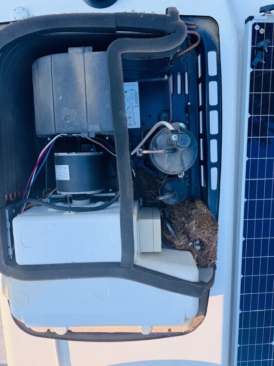

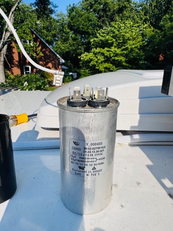

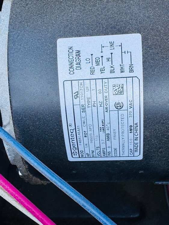

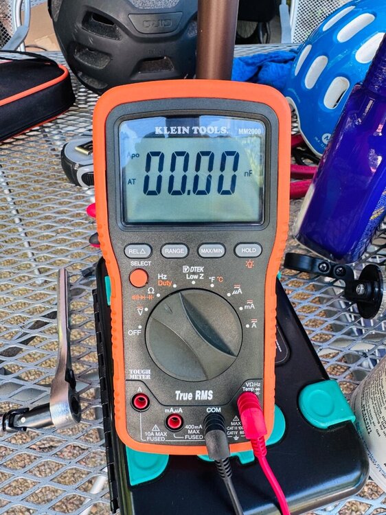

rideadeuce Posted June 16, 2024 Posted June 16, 2024 (edited) So the unit is over 6 years old, thought it might be time for some maintenance. 😁 Also, making some high pitched screams (fan motor?) occasionally. and not cooling as well sometimes. Took the shroud off by removing 4 phillips (easy). Found a birds nest from early this spring, I guess, 2 hatchlings didn’t make it. Probably hatched while in FL. The nest and eggs look fairly fresh. Took out the big and small capacitors (5/16 screw that is needlessly hard to reach), both tested WNLs (Big silver one 55/15 +/- 5% micro farads and small black one 43-53 micro farads). Fan shaft had some wiggle to it but pretty tight. Maybe a bearing went bad? Not sure if it was a good idea but sprayed the shaft toward the motor with some CRC power lube. Thought maybe it would help give me some time before replacing fan motor. Got pics of everything for later if I have to order. Cleaned the coils with some mild soap detergent and low pressure water from hose. Let everything dry, cleaned the shroud and put everything back together. No noise and air coming out is definitely colder or I am just enjoying it more after being in the morning sun! Hope it helps someone tackle their maintenance. Really not that hard. Best, Mike Edited June 16, 2024 by rideadeuce 4 - Mike Brentwood, TN - 2018 Elite II - Spirit of Adventure Hull #308 - 2016 Toyota Tundra Limited 5.7L Class IV hitch with 12k lb coupler, Dobinsons HD 2in Leaf springs, Timbren bump stops, Eibach Pro Truck Stage 2R, Mechman 370 amp HO alternator. Oliver upgrades: Starlink, Cradlepoint cellular modem, Victron Multiplus II 12V 3000W, Ekrano display, Orion XS 50amp DC/DC charger with Anderson connections, Toshiba 6-in-1 Microwave oven - air fryer combo, Atmos 4.4 15k AC/12K Heat pump, Nova Kool 5810 fridge, Epoch 460aH x2, 520 watts solar on top, Custom aluminum bicycle rack, Alcan Springs, Bulldog shocks, Falken H/T02 tires, Seabiscuit Metal Designs front storage box and moose rack.
BigTexas Posted June 16, 2024 Posted June 16, 2024 Thanks for posting Mike. I'm a firm believer in having spare capacitors on hand as cheap insurance because you never know when they're going to stop working and their easy to switch out. I'm using your pictures to order the spares. I'm guessing the black capacitor is an added on hard start capacitor? Do you have the Oliver factory installed Micro-Air Easy Start option on your A/C unit? I know the Micro-Air unit also contains a capacitor but I've not taken the time to look it up. I'm thinking an A/C unit wouldn't have both a hard start cap and the Micro-Air. I need to do some preventive maintenance on mine. They're easy to forget about until they don't work. 1 Big Texas – 2018 Elite II, Twin Bed, Hull #306 2015 RAM 1500 3L EcoDiesel, Anderson hitch
rideadeuce Posted June 16, 2024 Author Posted June 16, 2024 (edited) @BigTexas Mine does have an easy start installed but I am not knowledgeable enough to know whether the black small capacitor is related to it or not. I took pics to order the spares like you stated, hope it helped. Most likely a fan motor will be my first purchase. My Dometic Penguin II 13.5K has run continuously for 6 years, summer and winter, heat and air. It has been very dependable so far, albeit loudly. Looking at serviceable parts at this point and then replacement when the time comes. Edited June 16, 2024 by rideadeuce 1 - Mike Brentwood, TN - 2018 Elite II - Spirit of Adventure Hull #308 - 2016 Toyota Tundra Limited 5.7L Class IV hitch with 12k lb coupler, Dobinsons HD 2in Leaf springs, Timbren bump stops, Eibach Pro Truck Stage 2R, Mechman 370 amp HO alternator. Oliver upgrades: Starlink, Cradlepoint cellular modem, Victron Multiplus II 12V 3000W, Ekrano display, Orion XS 50amp DC/DC charger with Anderson connections, Toshiba 6-in-1 Microwave oven - air fryer combo, Atmos 4.4 15k AC/12K Heat pump, Nova Kool 5810 fridge, Epoch 460aH x2, 520 watts solar on top, Custom aluminum bicycle rack, Alcan Springs, Bulldog shocks, Falken H/T02 tires, Seabiscuit Metal Designs front storage box and moose rack.
