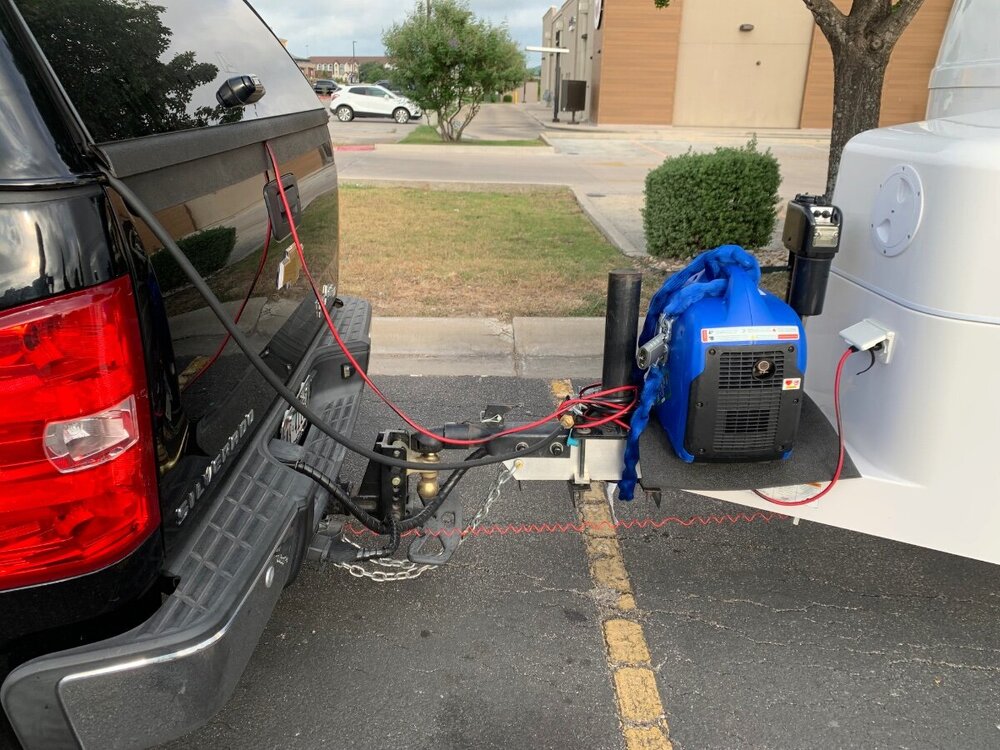

Ronbrink Posted September 9, 2024 Posted September 9, 2024 A Jackery 2000 pro will not run any air conditioner, better suited for small AC appliances or DC supply/charging purposes. Yes, a small dual fuel inverter generator can be used to power the Truma, at minimum 2200W. I carry a dedicated 30# propane tank under cap, which will provide up to twenty hours of a/c comfort for long evening/night periods of cooling. Once that supply is exhausted, I can tap into one of the OTT-mounted propane tanks unless time is taken to refill. I stage the genny on the tongue of the trailer secured with a chain. I primarily use this setup for overnight stays while underway to a campground that has power service. Depending on how an Oliver is wired dictates whether or not the Truma can be used via the inverter. I had to install a dedicated transfer switch to be able the run on DC. If capable, then solar and/or a small generator will sustain limited use of the a/c in actual boondocking situations. 4 Ron and Brooxie | Clear Lake (Houston), Texas 2020 OLEll, Twin, 579: No installed solar, dual 30# propane tanks w/GasStop safety devices, Renogy 40A DC-DC charger, 460Ah LFP battery bank/Victron SmartShunt, auxiliary Cerbo-S GX/Victron 30A Blue Smart IP22 Charger combo, interior mounted Hughes Autoformer, twin independent sliding Lagun mount tables, extended dinette table and pantry landing, tongue-mounted hoist, Beech Lane refrigerator Ventilation/Evaporate Coil fans, metal valve stems with TST cap sensors and signal repeater, Waste Master sewer hose management system, Dreiha Atmos 4.4 A/C upgrade/Ceilo Breez Max thermostat, FlagpoleBuddy Starlink Mini suction mount kit. 2019 GMC Savana 2500 Cargo Work Van: Explorer Limited SE, Low-Top 7 Passenger van conversion, 6.0L V8 Vortec, 6-Speed Automatic, RWD; Air-Lift LoadLifter air suspension/WirelessAir compressor; Bilstein B6 4600 Series shocks; metal valve stems for TST tire pressure monitoring system; Buyers Products cargo containment boxes/DC Cargo securement system; rear bumper DC-DC Anderson power cable outlet; 100Ah 12V portable power station/Dometic CFX 75L Dual Zone cooler; front 2” receiver hitch/QuikrStuff Mach2 double bike rack; Mechman 320A high output alternator; Starlink Mini/Veritas Vans magnetic mount.

silversportsman Posted September 9, 2024 Author Posted September 9, 2024 4 hours ago, Ronbrink said: A Jackery 2000 pro will not run any air conditioner, better suited for small AC appliances or DC supply/charging purposes. Yes, a small dual fuel inverter generator can be used to power the Truma, at minimum 2200W. I carry a dedicated 30# propane tank under cap, which will provide up to twenty hours of a/c comfort for long evening/night periods of cooling. Once that supply is exhausted, I can tap into one of the OTT-mounted propane tanks unless time is taken to refill. I stage the genny on the tongue of the trailer secured with a chain. I primarily use this setup for overnight stays while underway to a campground that has power service. Depending on how an Oliver is wired dictates whether or not the Truma can be used via the inverter. I had to install a dedicated transfer switch to be able the run on DC. If capable, then solar and/or a small generator will sustain limited use of the a/c in actual boondocking situations. Thanks, Ron. I think you have confirmed my thoughts. I appreciate you taking the time. Nice setup by the way. Bob 1
