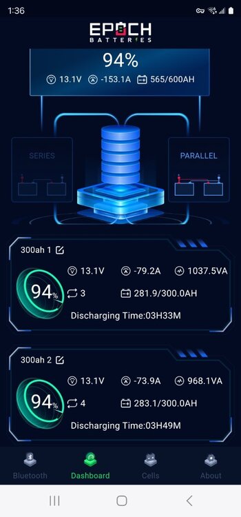

Hello JD.  We have the 13,500 BTU Dometic Penguin. Neither my wife nor I are too bothered by the noise unlike many others. And yes, we do have the solar package. We were drawing roughly 150-160 amps with the a/c running (see screenshot below).  We are looking at alternative a/c options, but at this point, we have already spent a great deal on the LiFePO4 system.  And, we are about to upgrade the shocks - we just received our Bulldogs and are cautiously pessimistic as we note that they are made in China.  Hoping our leaf springs last a while longer. So, our major upgrade is complete, but there are more to come.  With regards to dc2dc charging, we are considering a 400 w suitcase to add to the rooftop capacity and we can boost the output from the alternator above the 30 amps it is set at.  Math tells us we will be short, but empirical testing will provide more insightful info.

Note that each battery is drawing about 79 amps. BUT, we had our 3-way Dometic absorption fridge on DC - this consumes  a whopping 15 amps on its own.

Your 153A reading at 13.1V translates to 16.7A on 120VAC (153 x 13.1 / 120). Given the Atmos will cool well using 10A on 120VAC it should consume 60% as many AHs! (or last 67% longer on equal AHs). I cannot stand the NOISE of the P2!
