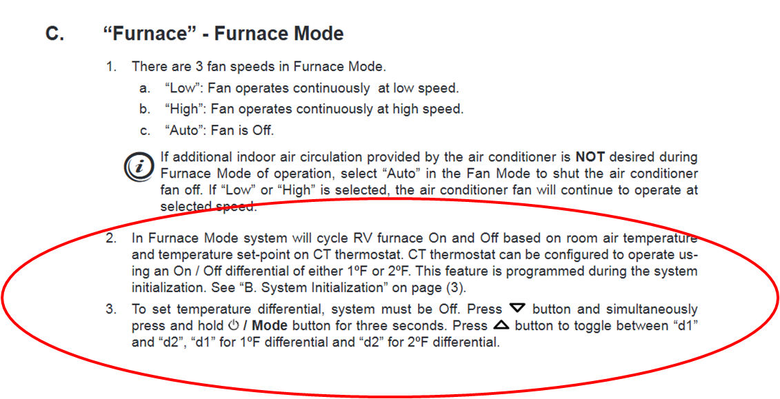

I had a similar clicking in the dometic control box. I eliminated it by changing the temperature differential setting on the dometic thermostat. There are instructions in the thermostat manual.  I'll try to attach a picture.
Steve
