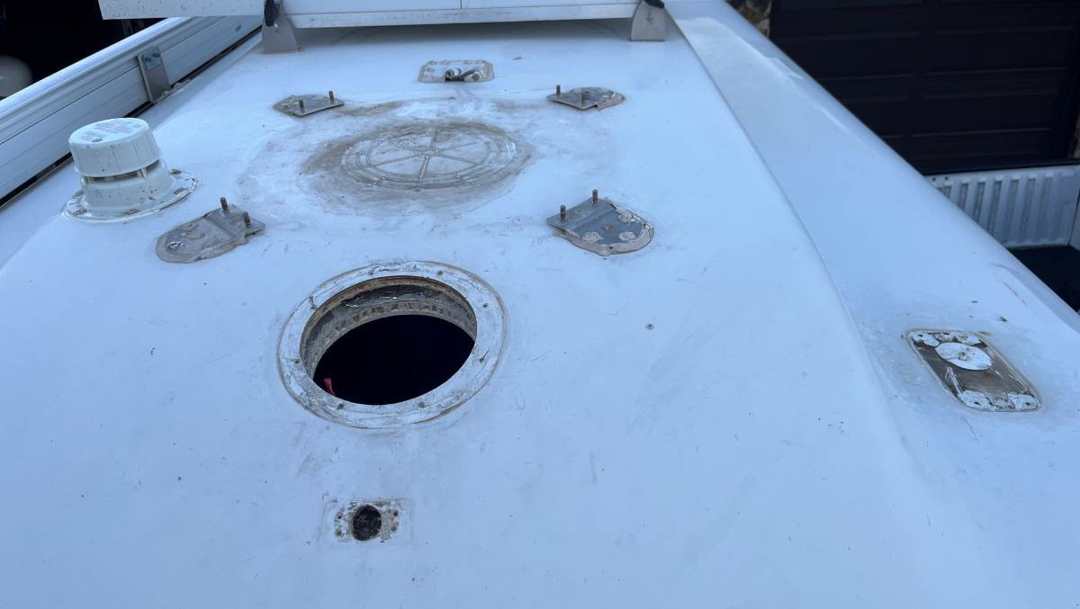

I have also plugged the holes made for the TV mount, the drain pull handle in the bathroom, the door hook outside, both cameras and everything in these pics (see before and after).
Edited by jd1923
Wow, that turned out great. That is the product I was considering using. Seems very popular with boat owners. Seems a lot simpler than mixing resin and catalyst. I was wondering how well it would match.
