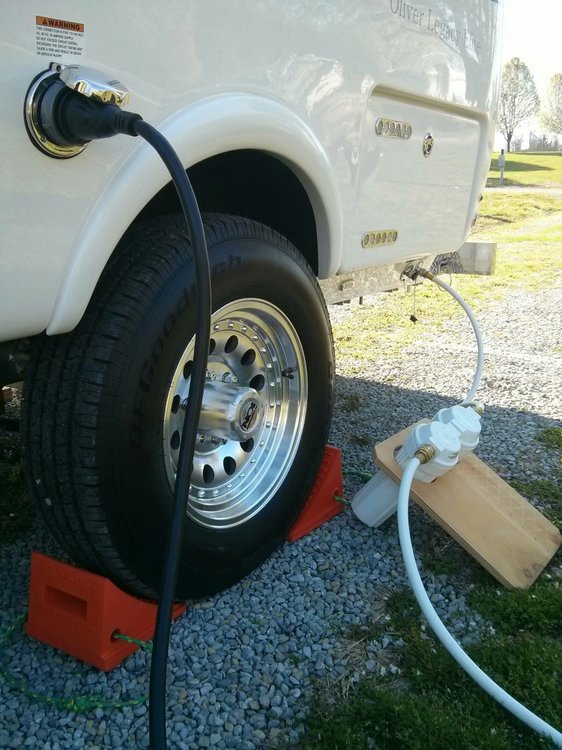

I decided to go with a two canister system and it has worked very well. I ordered it from: https://www.rvwaterfilterstore.com/index.htm
This is a great website and business. You can learn a lot there, at least I did. They also sell the best hoses I've come across. Our first filter is for sediment, the second is a carbon filter that is rated to .5 microns. Plugged into the spigots at all our camp spots, the water flow has been more than adequate. Although not in the picture below, I have since added a wye to the outflow side of the system so that I can fill water jugs more easily. Currently, we don't drink from the onboard tanks but have separate water jugs for that. The tanks are probably fine and no doubt we'll do that some day, but old habits are hard to break I guess. Plugging the filters into the "City Water" and "Fresh Water" inlets has been very easy and works well. I have not yet tried siphoning through the filters using the on board water pump. I hope this will be doable.  The stand is just a piece of plywood I drilled two holes in that the filter housings drop in to. Keeps connections off the ground and stores flat!  A pretty simple setup and replacement filters are available everywhere.
Dave
