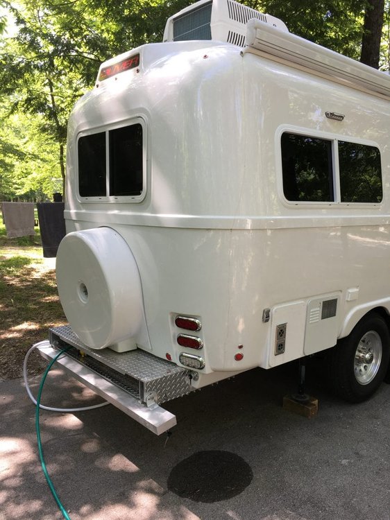

2. The drip line is outside the trailer so there is always a stream of water coming off the trailer. Not an issue for me, and Dusten added some flexible molding to route the water away from windows..
Regarding the Atwood A/C, how much water runs down the side?  We are supposed to go into production next week and were planning on getting the Atwood in place of the Dometic.  Just found out about the lack of a drain on the Atwood.  This concerns me about long term effects on the  gel coal/fiberglass.  For those who have the Atwood, can you provide your thoughts, please?

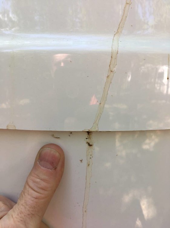

I think that this is an issue only if you live and camp in a humid climate. I was bothered by the water draining off the back in TN because there was some tree debris on the roof and the water stain was brown and difficult  to remove. I needed to use Starbrite marine hull cleaner to get it off. 409 would not touch it.
OTH I live and camp in an arid climate and the water will not be a problem IMHO.  I have no regrets about the Air Command, but I do recommend that you get the bigger model if you plan to use it a lot. Mine is the 13.5k "equivalent" and it works pretty hard on nasty hot days, but I chose it due to the ease of running it off my generator, and  because of its REALLY quiet noise level.

I have the same "stain" as John and I have a Coleman Mach 8, condensate water running off the roof wouldn't bother me, or the hull I would think, it's if there's crap on the roof that mixes with it and it's parked near shedding maples trees.
While the awning gaskets work great to keep the rain from running down the sides, they also collect the water and debris to properly mix it and then focus the runoff to one spot so it REALLY shows...
