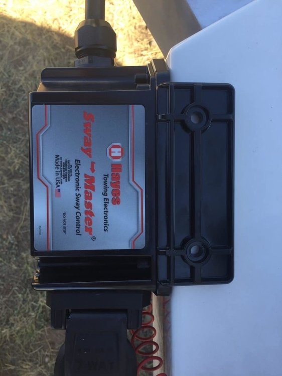

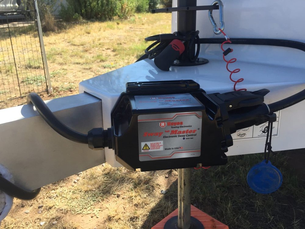

Bill (rideandfly) generously gave me some very helpful photos and information about how he installed his Sway Master. He installed his on the (aluminum?) tongue to avoid messing with the fiberglass covering the A-frame.
I am considering mounting mine on the A-frame, as shown in the photos here. I have no problem with mounting it on the outside of the fiberglass if 1) I will not damage the fiberglass more than putting two holes in the top and two on the side for the screws needed to secure the Sway Master, and 2) if the unit will not get smacked by my Tundra’s bumper during a left-hand turn.
There is a gap, about 1.5 inches wide, between the fiberglass and the A-frame beam, as can be seen by one of the photos. I am thinking of filling this space with some material (hardwood? aluminum?) before I screw the unit with four screws into the outside of the A-frame cover. Here are the issues I can think of asking for advice on before the installation:
1.     What kind of filler material that I could easily obtain from my local hardware store would be best?
2.    Four screws came with the unit, but I suspect that there is a type of screw that would be best to help avoid damaging or discoloring the fiberglass. What type of screw should I ask for at the hardware store?

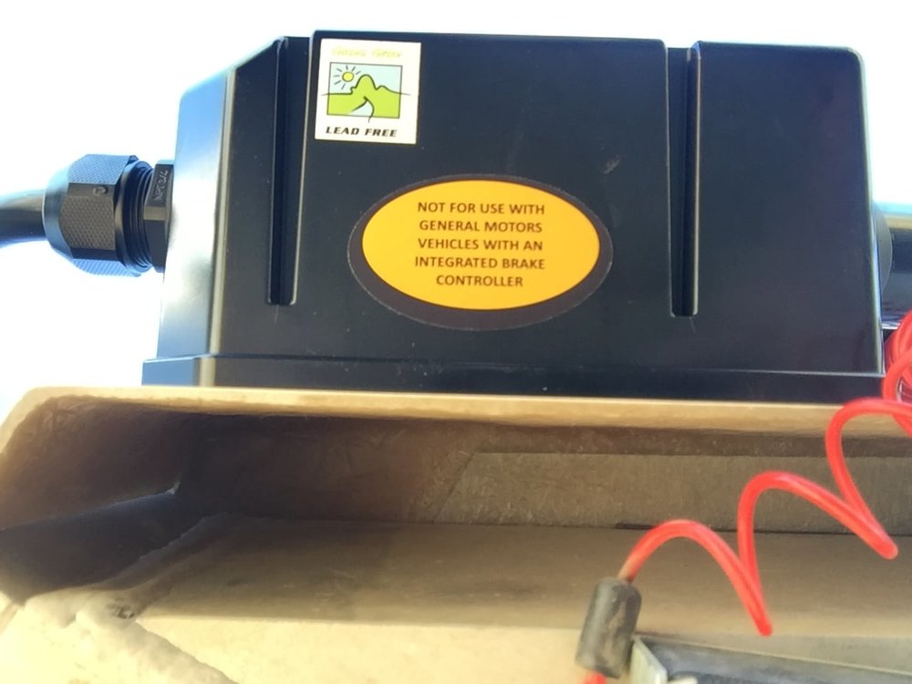

3.     The top of the unit, where it would attach to the top of the fiberglass cover (see photo), would accumulate some moisture. I wonder if this would be a problem and, if so, would it be a good idea to fill it with some material or cover the unit when I am attaching it with some thin piece of metal or other material? (Should I just cover the screw heads with some kind of sealant?)

Jeff, wanted to share additional information with folks here that aren't familiar with the SwayMaster, hope you don't mind.
Hayes intended the SwayMaster to be installed on the trailer tongue A frame normally made out of carbon steel. The position Jeff shows is consistent with Haye's intended installed angle. Hayes said my installation location was fine for the SwayMaster operation, too. With the mechanical talent here, hope ideas will be shared to help Jeff with his SwayMaster installation.
Here's my SwayMaster installation without WDH, our Ollie weighs in at 4950lbs with empty water tanks.   Used 1 1/2" x 1 1/2" x 1/4" aluminum angle and have additional detailed photos, too.  Have not had any clearance issues with my installation so far and really like the SwayMaster unit for Sway control with our Tundra. It has activated a couple of times applying trailer brakes before I noticed sway, once coming down a mountain when I was going too fast through a curve and once during high cross winds.

Because the Sway Master has some internal electronic sensors, I would hesitate putting any type of covering over it, especially metal.  I have an Elite and it is mounted on the tongue.  I used stainless steel hardware, no discoloration and very strong.  Not here, but in another area I used a piece of Oak as a filler to keep the Fiberglass from squishing. I extended the tongue and used the open holes to mount the Sway Master.  I do wonder about the Sway Master being mounted at an angle not parallel with the direction of travel.  I am not an expert but would suggest calling a technical advisor at e trailer and discussing the mounting and your concern with water pentatration.

I have a 2016 Elite.  At that time, Oliver manufactured Ollies with a tongue that could be extended WAAY out and could even be removed.  Every 6" is a hole that could be used to adjust the length the tongue is extended.  I have my tongue extended 12" and it rides very well.  My TOW is a Toyota Tundra V8.  Unfortunately, Oliver no longer has the extendable tongue.  They currently have a "fixed" tongue on new Ollies.
Look at Bills mount.  He used some aluminum flanges he made from Aluminum stock.  I did the same, used the stock, marked where the bolts were and drilled holes in the stock to fit.  I went to Fastenall and bought bolts that are longer than the Ollie stock bolts.  I then put the longer bolts back in with the appropriate hardware and torque.  I still had 1.5 inches of thread on the bolt so I then put the aluminum stock on that I previously had drilled matching holes in.  I put the Sway Master on the aluminum stock, centered the Sway Master bracket and marked the holes.  I then drilled the holes in the top part of the aluminum stock and mounted the Sway Master with stainless steel bolts.  I put a second nut on top of each bolt. Now the Sway Master is parallel with the tongue, I drilled no holes in the tongue, only in the Alumnium stock.  I bought two black lots that were  1.5 inches longer and more threads on the end.  If you go this route, make sure you get the hardened steel, usually #8 sold at Fastenall.
