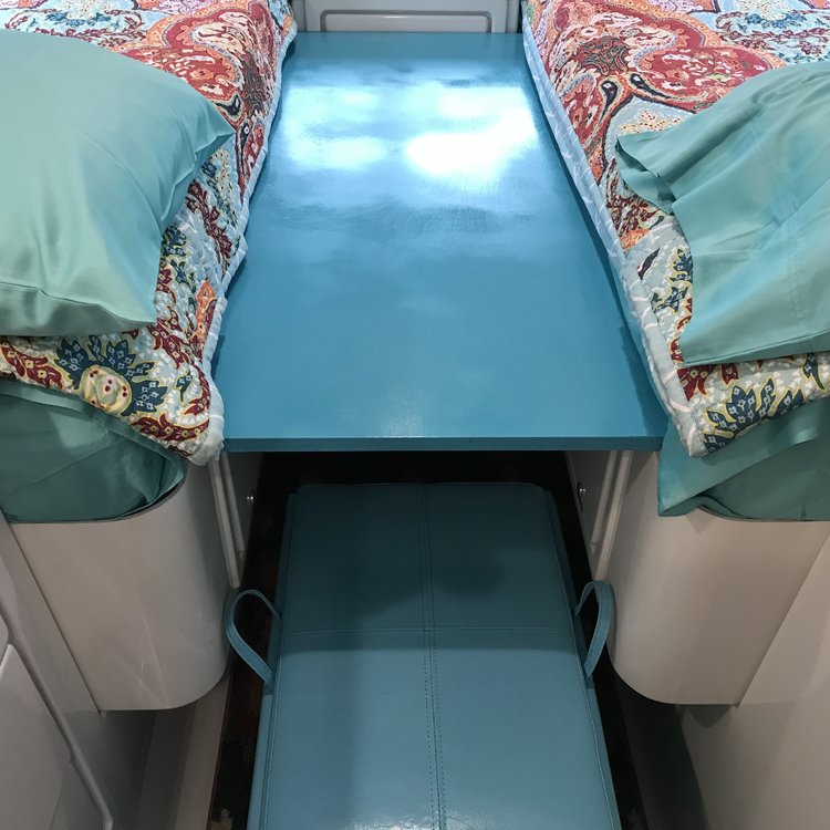

Not sure how the normal twin beds are configured but we have the raised twin beds and we just converted to a king. I used a 3/4” piece of birch plywood with a 5” piece of memory foam on top of it.
I did something similar. The space between the twin beds is 18” X 51”. I cut three 19”X 17” rectangles from 3/4” ply wood to sit on the fiberglass frame.  I cut a 1/8” X 1/2” lip so there is no movement, there’s 1/2” overhang on each side. A piece of high density 6” foam is level with the 8” mattresses. The three pieces of wood are small enough to store easily when not in use. We can also use one of the rectangles as a table between the beds when we’re in the twin bed mode and watching TV or reading. Mike
So I am assuming a 1/8” deep by 1/2” wild cut for the lip leaving 5/8” depth of plywood remaing on the lip to hold the total weight?
Yes. Just enough to prevent any lateral movement.
