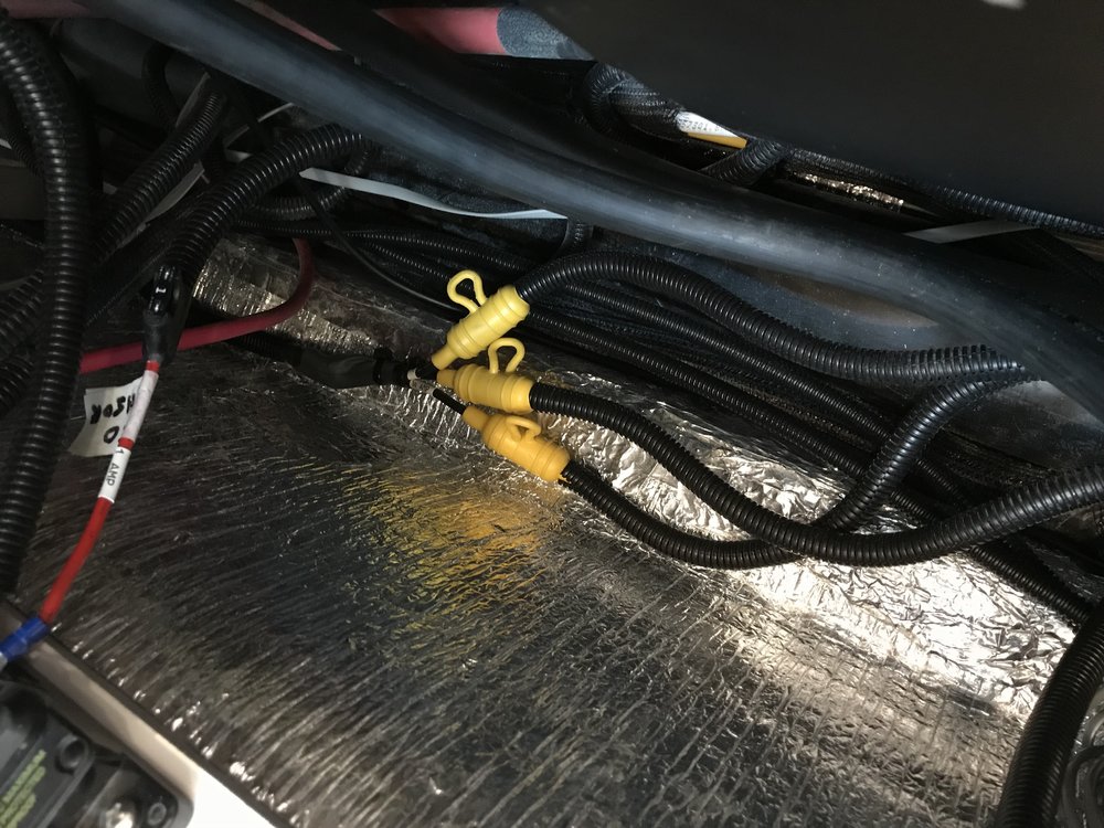

If it will be outside, stored half a year, you should probably also support the subframe to take the load off the suspension and tires. For a shorter time this is unnecessary. Stands are a good visual theft deterrent. You can remove the three jack fuses in the left rear electronics bay too, to make them inoperative.

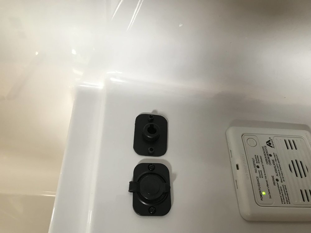

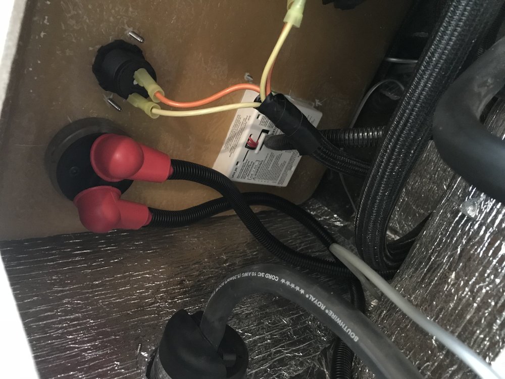

I added a master disconnect switch grouping the three jacks together for use both in my driveway and at campgrounds etc. as a theft/mess with deterrent.
