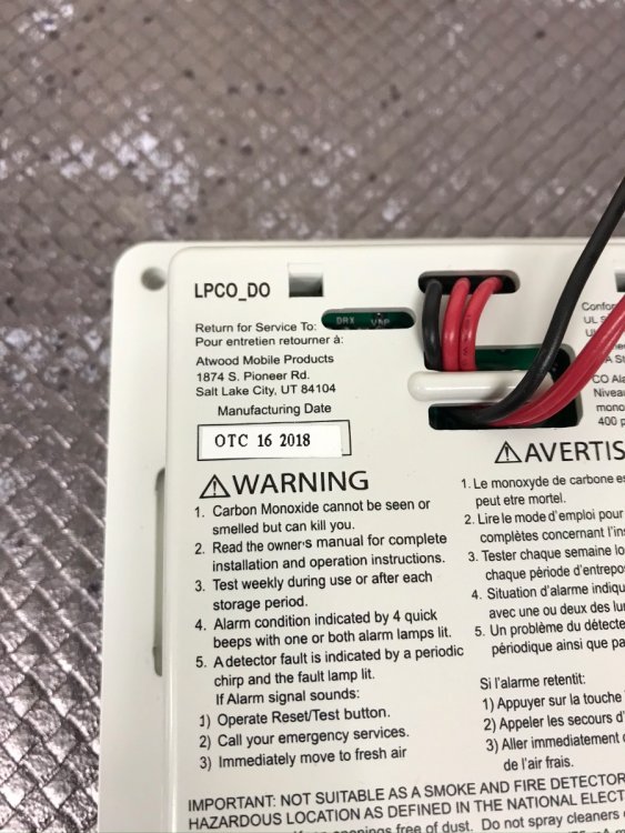

  6. With the help of Jason was able to acquire a new propane and co detector, the latest models were manufactured in 2018 so you are two years behind the curve from the get go. It is my understanding that you can expect around 5 years of service, even though the paperwork that came from the unit stated 7 years. As with most RV parts qualify in manufacturing is poor. Because of that I have installed quick disconnects to our unit. I figure I will be changing it out in a few years.

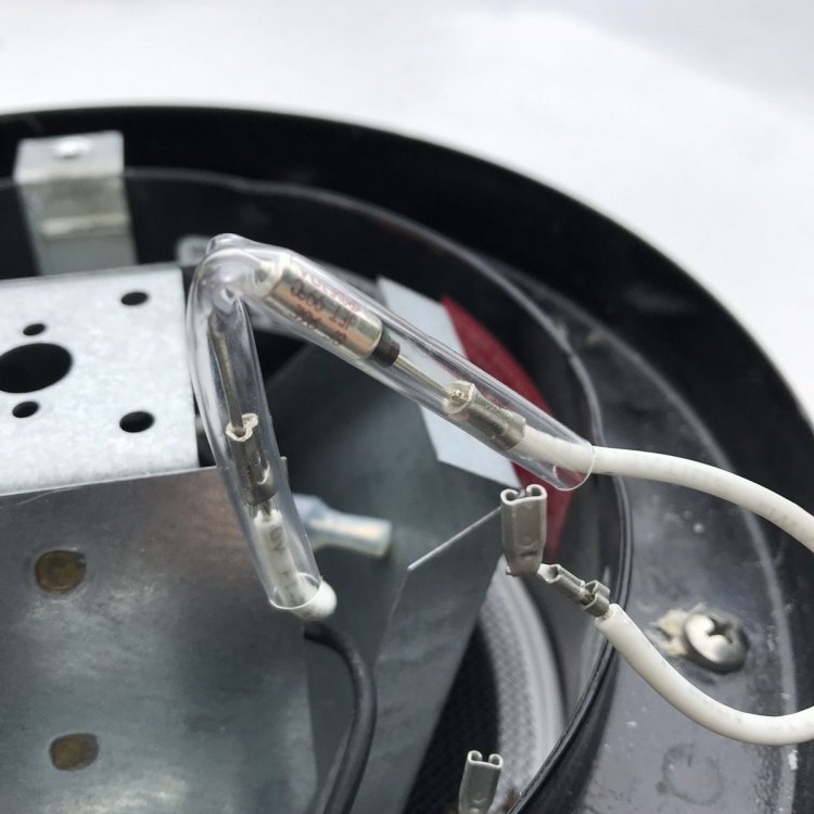

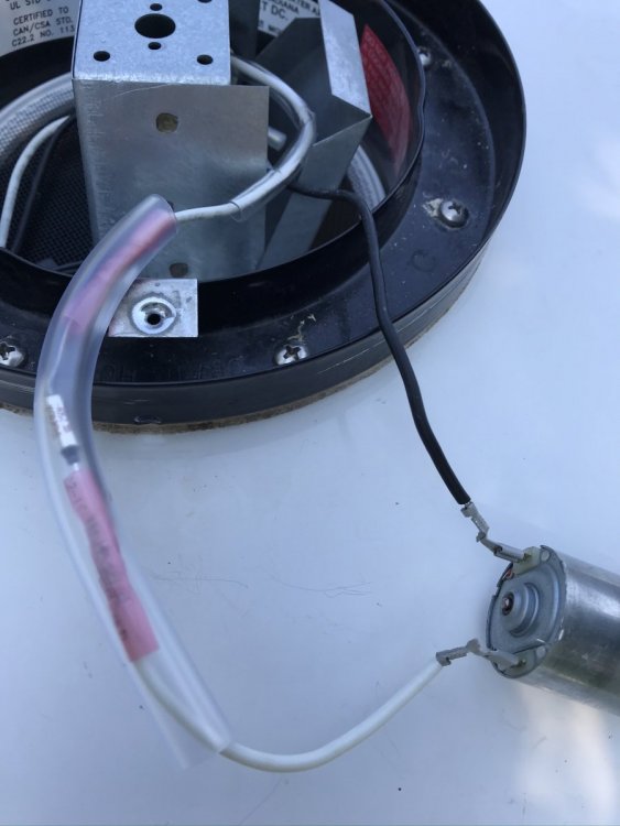

  7. Ok done thanks for the help, anyone need a thermal fuse I will send. The parts are real junk, standard for the industry I guess. And if you don’t watch the condition of your gasket material you will be doing the same . Not much fun hanging from a ladder. I will advise on how my gasket material holds up. Thanks all.

  9. Ok then, thanks for your help. It seems to me with the bathroom drawing moist air one would want a watertight crimp, just saying I don’t know much about this. I am going to give it a shot see how it goes thanks for your help..............
  10. I just tried a magnet 🧲 and there was no attraction, do you guys know what size wiring , as I cannot read the writing on the wires. I never used butt splice connectors do you crimp them twice?
  11. Do you remember what type of connector was used when you replaced the thermal fuse?
  12. Anyone know where I can pick up high Temp Parallel crimps, can’t seem to locate them🤔
