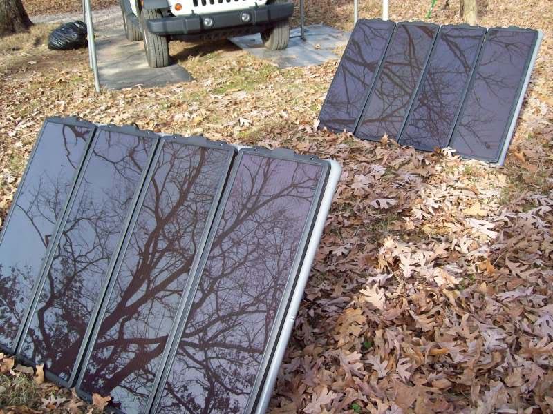

We did it ! We ordered two of the 60 watt sunforce setups. The auctions on eBay seemed to be stalled out at about $730.00 plus shipping, which was higher than I wanted to pay. I sent a PM to several sellers asking about a better price and combining shipping. Most were reluctant. But then I recieved a response from a supplier that wanted to negotiate. We did. Our final cost for both complete setups delivered to the house was $648.00 ! We paid through Pay Pal so we would have all of the benefits provided by them. The UPS Guy delivered them today. The first thing that I noticed was that they were heavier than I expected. Everything was in order, in the first box I unpacked and assembled. Everything went well with the assembly. No missing parts and all connectors mated up well. The first check of the output while still inside the house, in artificial lighting only, was an output of 9.2 volts. I was worried about how sturdy the plastic pipe adjustable frame was, until I had it assembled. The frame is made of schedule 40 plastic pipe, which is probably the reason for some the extra weight. Each of the individual fifteen watt panels is well framed and braced. The screws all seem to be stainless steel. Though the assebmly went quickly, I wouldn't want to do it every time we go camping. We will likely find a way to carry the panels fully assembled and ready to deploy. The cables that come with each are only twelve feet long. We will need longer cables. They seem simple enough to make and will not add much to the overall cost.
The project is going so well, I am going to open the other box and start on it right away. Betty may not like the looks of the livingroom when she gets back home from her mom's house ! :mrgreen:
Got the other panel assembled. Ran the initial tests to insure that each panel in each array is putting out voltage. The kits each have a led plug in quick check for testing the output. All panels on both arrays working well. Hooked them up to the connectors that join the individual panels in each array. Then I tested the output voltage for each array. Just the least difference of alignment towards the sun made several tenths of volts difference in the output. As seen in the photo below, one panel was putting out 23.5 volts at no load and the other was putting out 23.2 volts. Both tested at no load, open circuit. The charge controllers appear to be the weak part of this setup. Their cut in point is at 13.0 volts and cut out is at 14.2 volts, with led indicators to tell what they are doing. It may be that we will watch the prices of some of the new charge averaging type controllers that can adjust the voltage for a more efficient daily charge. Here is what the two arrays look like:

Here are the weight and measurements: Weight of each array: 45 lb. Size of each array: 55" Wide X 39" Tall X 3" Deep
Since they are heavier than we thought they might be, we won't be wanting to lift them around very much ! At first, we thought that we might store them on an expedition rack on the roof of the Jeep. We have been wanting a roof rack anyhow. But after handling them some, we don't want to be "horseing" them around that much !
