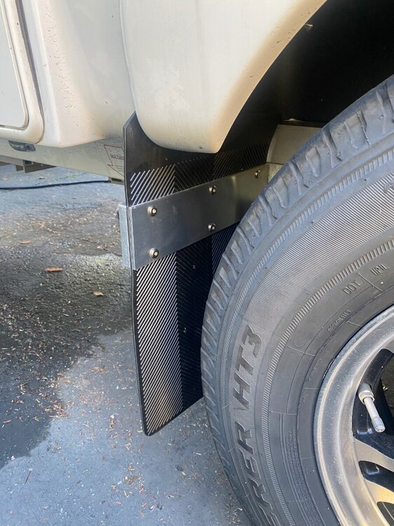

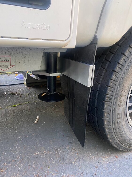

I just finished this great mod!  Thanks Minnesota Oil!
FYI, this modification can be done with hand tools, it just takes a lot of elbow grease with a hacksaw.  I used a woodworking bandsaw with a fine blade and 2" hole-saw."   The edges were draw-filed for a polished look.  I didn't mill out a recess to fit the frame per Minnesota's plans, but I did drill and bottom tap blind holes (not all the way through) for the mud flaps.
All the aluminum was available at Amazon:
  • 12" x 8" x 1/2" plate
  • 12" x 3" x 1/2" bar
  • 12" x 3" x 1/8" bar
I had some difficulty finding decent mud flaps.  I ended up getting a set at O'Reilly's Auto Parts, they had a chevron patten on one side and vertical lines on the other.
Cheers! Geoff
