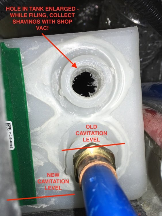

Without a doubt, the fresh water pickup location on the early hulls is a complete disaster, what were they thinking, it leaves about 12 gallons unusable unless you raise the tongue high, which is very bad for the fridge... Oliver will fix it for free if you visit the factory. To the best of my knowledge they will not pay for it to be done locally, since it requires special router tools and skills, to spin weld a new threaded fitting on the top of the tank. You could open a Service Ticket and ask them if this policy has changed. IMHO they should issue a Technical Bulletin and just fix all the ones in the field, at no charge to the owners. Instead they just changed the technical specs from “32 gallons” to “32 gallons design capacity”. LOL…. How lame is that?
I did my own modification, but it requires a certain amount of fabrication skills. You might want to read the beginning of this thread before you contact Oliver.
https://olivertraveltrailers.com/forums/topic/2261-how-to-fresh-water-tank-suction-tube-mod-no-spin-welding-required/
