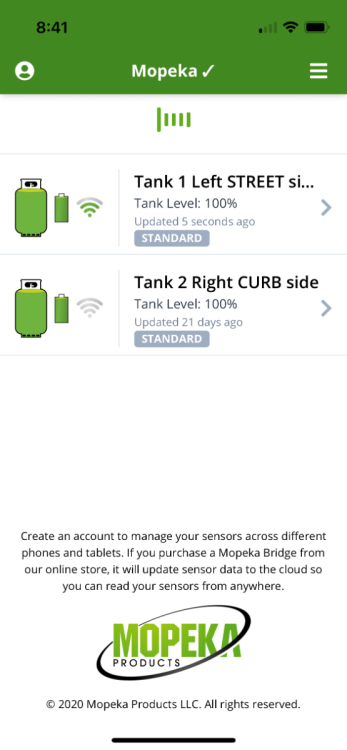

Also consider a Mopeka propane detector - I have mixed feelings about mine, it tends to eat batteries but when working it is very handy.
